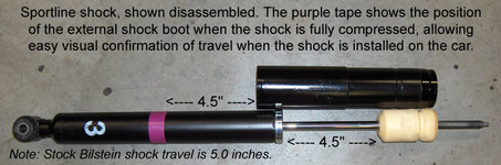

The driver front is 13 1/2” and the passenger front is 13 1/4”
I’m at just over 13” on the rear with a full tank of fuel.
WOW! That is extremely low. Stock is usually around 15", and Sportline is normally around 14" or so (give or take a bit). New front struts will lift the front slightly vs old/worn struts with lower pressure. Depending on which strut stop buffers are installed, the front may be close to, or sitting on, the stop buffers.
IMO, your front is not too high, but rather the rear too low. If anything I'd try to get the rear up slightly with a full tank. The rears may also be sitting on the stop buffers, but this is difficult to determine. I apply colored tape to rear shocks at the point where the stop buffer limits travel, this way I can look under the car and see how much travel is available. Photo attached below.
Not sure why there is such a difference between the front wheels. The car looks pretty level now and is driving perfectly straight after an alignment.
This is pretty normal. Almost every 124 that I've measured has had 1/8-1/4" difference left to right. Don't worry about it.
