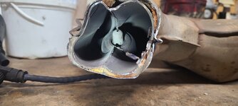

It was definitely giving all she had! If it's plugged cats or not the drivers side pipe is collapsed from hitting something right before it goes into the cats. My state won't smog 25 or older cars so... what should I do next. I have faith in what's behind the cats and MB engineering. Open to suggestions, but I think some test pipes are in order to replace the damaged pipes and cats.

And so it begins... a lot bigger in-person than it was tucked up in the tunnel. You can see how hard of a hit it took. Looking in the back the honeycomb is still intact on both cats but shaking it around I can hear large chunks. The 02 sensor also took a hit and I can't get it out, there isn't enough room around it to get anything but a thin wall 12pt socket on it, maybe and the wire end is bent over.

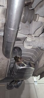

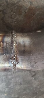

The 2.86 rear diff was definitely worth the cost and effort. The exhaust now has a flex pipe to relieve too much tension on the vband. Got the front bumper mounted and fitment is good. I have a new used grill to go on as well as some body work on below the headlight. Rear bumper is partially fitted need to do the side mounts which is a bit tricky.
