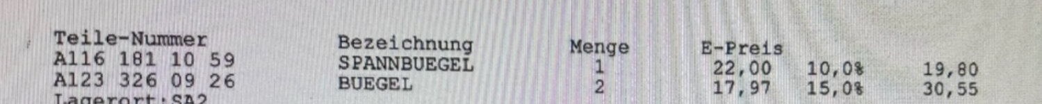

Picked up a few parts from the dealer today. Amongst them is the fuel like from fuel pump to fuel pump, one half of the fuel pump bracket. Seems to be the wrong one as it‘s got space for the pressure accumulator which the older models have. Either i’ll leave it like that or just cut that part away. The lower half of the bracket is NLA and has to be acquired somewhere else.
And some other bits and pieces like rear sway bar brackets.
IMG_5955.jpegIMG_5956.jpegIMG_5957.jpegIMG_5958.jpegIMG_5960.jpegIMG_5961.jpegIMG_5962.jpegIMG_5963.jpegIMG_5964.jpegIMG_5965.jpeg
