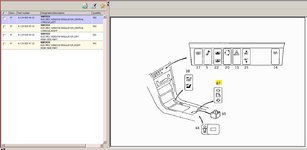

Another subject for this thread could be "Nerding around inside the EPC." Anyways, while my center console wood veneer pieces are off being re-finished by Madera, I was looking up the EPC for the front LEFT, and front RIGHT window switches ----
Does anyone know - Are these window switches available in handed format?
In the below picture taken from the Internet, you can see that a 500E has different left/right iconography on the front left/right window switches.
In the below EPC diagram for the E500E, you can see that there were originally two part numbers for the handed window switches ---
  • 124 820 89 10 (left)
  • 124 820 90 10 (right) <--- however this has been replaced by 89-10 in the EPC and it says "only replaceable in pairs" whatever that means???
In fact, I tried to order both 89-10 and 90-10 and Naperville let me know that I could only order 89-10 ---- which is the driver's side switch.

I have not, however the switches are easy to refurbish and the switch cover is easily swapped so the switch should be identical. To disassemble, pry the cover off of two plastic pivots, one each side. Be careful of the tiny spring and ball under tension. I understand you may just want new ones. I have spare covers if you need.

Yes, the switches came in "left" and "right" handed pointing variants with the diagram on the switch. These should be available from both MB and aftermarket sources. If not, the switches are an easy enough find in wrecking yards.
The E500 came, if I remember correctly, with "auto down" switches with an extra detent that moves the windows all the way down with a single touch. Definitely the facelift W124 cars (1994 and 1995) had these; I am not sure if earlier (1992 and 1993) 124 cars including the 500E had these switches from the factory. They are different part numbers for the "one touch" and regular switches, though.
1-touch down was part of the 1990-up refresh on all 124's.
No dice on aftermarket sources for the switch, btw... appears all the WP/IMC/SSF/etc vendors are also rolling to the left side.
Thanks gents. Well, if I buy a new switch for the passenger side i will then just buy a new drivers side switch and swap the rocker cover plastic over.
