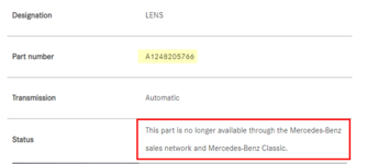

Is MBoemparts.com reputable? I googled the E500 Euro spec lens part number (taken from gsxr's link for facelift a E500 and its showing that it is available as well as other outlets. Assuming those part numbers are correct. (classic center is also available) I thought they are NLA, and adds to my confusion.

MBoemparts is MB of Naperville, IL. Search the forum, there's a promo code offering free shipping on orders over $100 for forum members. They are a dealership and only sell Genuine Mercedes parts.
I'm not sure where you are seeing the E500 lenses showing available for purchase, but trust me, they have been NLA for at least 3+ years. Only the standard lens (E320/E420) are available. E500 Euro lenses for right-hand traffic (USA/Germany) are 124-820-57-66 and 124-820-58-66.
https://partssearch.mercedes-benz-classic.com/parts/A1248205766?tt=automatic
