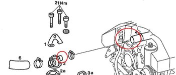

I am getting ready to replace a coolant pump and I forgot to order the 57 mm long hose that goes from the water pump (intake pipe socket to be exact) to the intake manifold. I tried measuring mine, but the center is so much larger than the diameter of the male fittings at the ends that it's hard to tell. It looks to be about 1 3/4" to 2" at the ends. The dealer didn't have this hose in stock, so I was considering trying to match it with a house at NAPA, just to get the pump in for now. Does anyone know the outside diameter of the male fittings on this? Thanks.

I have my old Waterpump & hose still so I took some pics / measurements for you.
The Male fittings are 38mm diameter. My old hose had bulged out at the centre – but the new MB hose was straight through.
Thanks! That looks to be about 38mm/1.5" ID hose. My hose is bulged in the center too, so it's probably a ticking time bomb. BTW, if you order the Graf water pump from AutohausAZ (made in Italy), it does not come with the gasket for the pipe socket (MB#119 201 01 80) that mounts on top of the water pump. For whatever reason, they include the O-ring that comes with the later models that have the one-piece thermostat housing.

I matched the short hose with a 1.5" ID hose from Autozone and then cut it to fit. My old hose was living on borrowed time.
