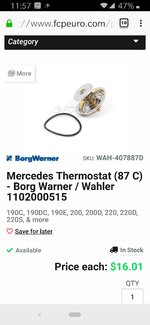

I think you mean Borg-Warner? They are claiming it's a reboxed Wahler, which should be fine. I think the OE unit is Behr but FCP does not carry that one in aftermarket form. You did the right thing by *not* buying Meyle.
https://www.fcpeuro.com/products?keywords=1102000515

I think I made a mistake, the thermostat is Borg Warner and not "Wagner".
It's made in Germany, but if this is a "no-no" I'll return it to FCP

FCP says it's Wahler. It should be fine. Wahler is an OEM for some MB parts.
