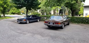

I forgot to add a picture of 124's stablemates, my Milanbraun 77 450SEL and Dunkelblau 88 560SEC - both bought on the West Coast and brought to Ontario by yours truly (the only classic Benz I bought locally is one that I bought to be parted out, a Euro 280SE W116).

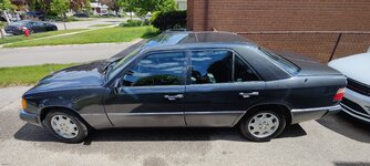

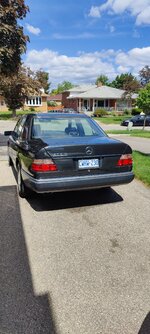

It's been a while since I posted an update, the car is finally running very well and to my liking. Got it registered and insured back in April and drove it a bit in May, when it started running rough, misfiring and refusing to restart hot. On top of this it had 2 leaks from the radiator and another one from the trans cooler line. I was not happy, neither was the California car being in Canada. Long story short, did the following:
  • Spark plugs (Bosch non-resistor), dist. caps, rotors, ign. wires
  • Behr radiator, thermostat, temp sensors, rad hoses and exp tank cap
  • Ignition switch
  • Trans cooler lines
  • The PO changed the injectors to a mystery set that "kinda fit", thew were slightly off size wise and were not seated properly, some of the seals were pinched. Thankfully the original set was in the trunk and after some time in an ultrasonic cleaner they tested great, so they went back on. New seals went in
  • Fuel filter
  • Fuel filler cap and vent hoses
  • Steering drag link and steering shock
  • Upper strut mounts and bellows
  • Some other miscellaneous stuff (windshield washer pump and seal, etc)
I still have some things to do, mostly cosmetic but the car is going to sleep in an underground garage for the winter.
