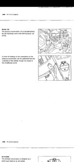

After that ASR light came on. Checked for codes and I get:
Pin #6:
11 - ABS/ASR hydraulic unit, solenoid valve relay (A7/3k1) - Where is this relay located? I can't find it in the schematics. A7/3 is ASR/ABS pump, but no "k1" to be found there.
17 - Battery voltage too low (we can ignore this)
30 - CAN data bus to EA/CC/ISC control module (N4/1), interrupted - This code was coming back always after longer storage of course with ASR light, even before I started all of this work. I was hoping that new NSS would fix this.
Pin #7:
2 -EA/CC/ISC control module (N4/1)
14 - ????? I don't see this code in DTC list.
The ABS/ASR pump has a couple of relays on it, but I think you need to remove a plastic cover to find them? Might just be a bad relay?
Pin 6 code 30 is a "phantom" code that almost always appears with either limp mode or some other ASR faults. Ignore this.
Pin 7 code 14 is "Closed throttle position switch (S29/3)" on models with ASR, but may also appear if the throttle linkage/cable is not adjusted properly.
:detective:
Thanks again, found the relay after more searching.
