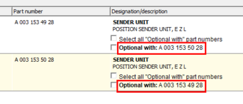

This is the genuine MB sensor I had on the shelf which appeared identical and did fit AOK (may not be exact part number chassis asks for though)
The car hated the new Lucas sensor. But was happy with this new MB one

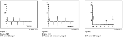

Also does anyone know where i can find a known good scope waveform pattern for the CKP and CMP sensors and or the TD and TN signals from the EzL module?
Not sure about the waveform pattern - don't know if MB published one.
