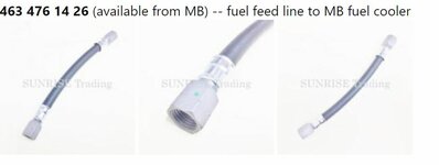

There are two fuel lines that are attached to the fuel tank.
One is #5 in the diagram, which is the feed line that goes from the fuel tank to the fuel pump. It is MB part number 463 470 00 75. Interestingly, I believe this hose was NLA from MB as of a couple of years ago.
Screenshot 2022-10-19 at 12.06.44 PM.jpg Screenshot 2022-10-19 at 12.06.50 PM.jpg
The other one is #56 in the diagram, which attaches to the hard fuel return line (running under the truck) that leads back from the fuel cooler, MB part number 461 476 02 26.
Screenshot 2022-10-19 at 12.06.09 PM.jpg Screenshot 2022-10-19 at 12.06.22 PM.jpg
The short line going from the fuel tank to the pump (#5) does appear to be available -- in the US at a list price of $112, discounted to around $85-90.
The return line to the fuel tank (#56) also appears to be available from MB - a US list price of $42, discounted to around $32-35.
The hard metal line that runs along the bottom of the truck from the fuel cooler to the fuel tank return hose (above) is #50 in the diagram, part number 463 470 03 64 -- this has been superseded to MB part number 461 470 03 64, and appears to be available from MB, with US list price of $65, discounted to around $50.
