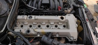

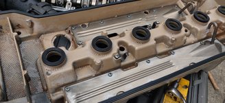

Today because the weather was so beautiful in the Atl, I decided to embark on replacing my valve cover gasket. Last week, while changing my spark plugs, I noticed quite a bit of oil in the plugs wells.
The entire job took me about 1 hour because I decided to 'detail' the valve cover before replacing the gasket.
I used Elring brand of gaskets, and changed all the rubber grommets as well (12 of them).
The moon -shaped gasket did not give any problems with installation.
I made sure the surfaces of the cylinder which the gasket would come in contact with were thoroughly cleaned and dry prior to putting back the valve cover.
I tightened to10Nm or 7.4 ft lbs (I'd like to think I did).
No leakages. I'm so glad that I spent quality time on this forum reading the "how to" articles.
