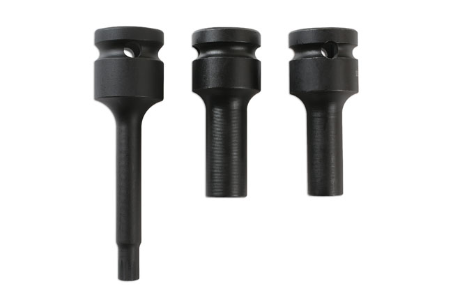

I have just purchased set of Oz Amg but i can't find what type or size nut to remove multiple
bolts on the face of the wheels Can anyone help

Thanks everybody but my local tool shop have found that Laser tools make a
specific remover for Oz three piece rims its now on order

Yes, Laser Tools 6345 is the right tool for these bolts:
I got my tool set from Pertsch & Partner:
Here is another set from Torque Parts:

While working on my rims, I came across information that Honda uses this specific bolt head on their minivan of all things. The upshot is that the sockets for the minivan crowd are readily available and less expensive. I initially bought the set of Laser tools, waited ages for them to arrive only to have it break on the third bolt. Searched around found the minivan alternative on amazon and they worked perfectly.
Minivan socket set alternative.
