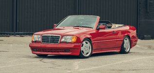

Sample photo of our E420 with 16x7.0 CLK wheels from a W208.
Stock springs, front "blue" (tall) spring cut 1/4 coil, 1 pt pad. Rear "red" (short) spring, 1 pt pad. Ride height is 14.25" front and rear with a full tank of gas. I don't recommend going much lower for a daily driver that sees real world roads with potholes and speed bumps. When the gap above the tire starts to disappear, IMO it's too low, and suspension travel starts nearing zero as well. Might look cool that low, but it will ride like crap.

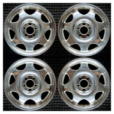

Late 90s CLK wheels are a popular choice. I have them on my wagon. Here's an example I found from a quick eBay search:
Those are my Favourite for these cars. I have a set on both my E420 and 300CE

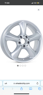

If the tire mfr spec sheet approves that width for that tire, yes. I think 8.5 might be near the max width wheel for a 225/45? This will be a bit "stretched".
:burnout:
i dont have tire mfr spec sheet, but from what i read on google it says that is okey

Look up the tire you plan to use on Tire Rack, check the specs tab.
Random Michelin shown below, says 8.5" is max wheel width for that size tire.
