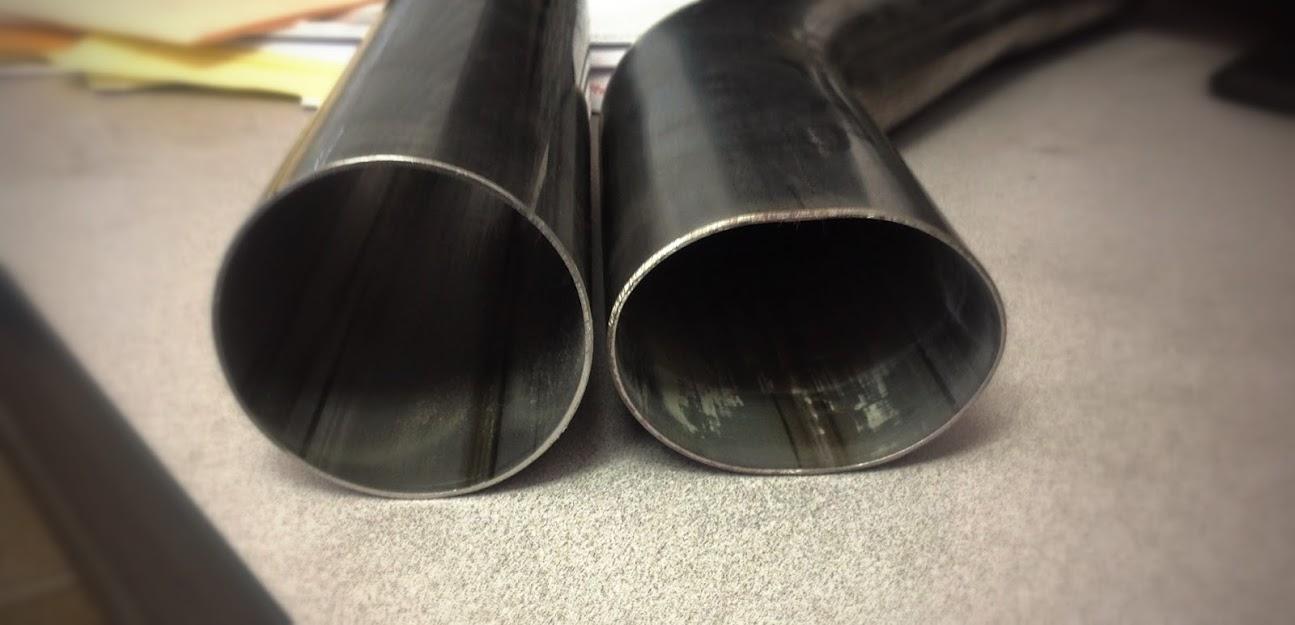

We have begun working on the Front section of this exhaust which will be a Manifold back.
This section will include "test pipes" we can't offer Catalytic converters unless you are interested in Race Cats 200CPI or 100 CPI cats which will be sourced from HJS.
Price is TBA at this point we are finalizing pipe lay out and doing a flow study to equalize the left and right bank the best we can utilizing pipe size and bends.
Here is a picture of something we are testing...
To the left is a 3" pipe which we plan on using on the right hand side (passenger side) of the Transmission. The problem with the 3" pipe is Ground clearance...
To the right is a modified pipe that has the same volume as the 3" pipe to the left. This gives us the ground clearance the 500E needs but now we are doing thermal studies of material growth. This section is real tight T304 has the ability to expand 1/8" we are looking into T321 or T439 which expands as much as 1/16"
Stay tuned...
