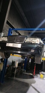

Right, here is the hit list for the E500 after several revisions...what started from replacing the rear shocks has quickly escalated. After owning and driving the car for a while now it's time for refreshing the car, as I enjoy driving this car thoroughly and it would be nice to keep it tip top for the next 5-10 years, a tighter drive is also welcomed (some key items are worn such as the engine mounts, gearbox mount, flex disc, rear shocks, etc.) The car just turned over 96,000km.
I welcome thoughts from you all, particularly regarding the jobs to do "whilst in there", otherwise I think this list of replacement parts will bring up my car to a very high standard - listed below is the job list and the part numbers of the parts I do not have.

I installed a new stereo (Alpine, off the shelf) and although I hardly listen to the radio, the antenna is seized. I can hear it trying to move up and down but it makes a buzzing sound and does nothing, particularly on start up/switch off. One of my friends had the same problem with his E500 and removed/repaired it, so I'll be going to his place one weekend to get it repaired as I can't really find a new one online.
Oh and the IR key died. I opened it up, re-soldered and it works perfectly now - it was a PITA using the key to open and close this thing from the passenger side! Only issue I face with the key fob now, the key fob itself is quite weak and does not really hold itself together as it did before, ideally I need a new key fob so I can transfer my key and circuit board over - I do not know if they are available from MB, never really seen those in EPC but I'll have a look this evening. I dropped it as I got out the car the other day and it broke into 10 or so pieces, luckily no drains nearby otherwise it may have been fatal!

Thanks for chiming in / for these thoughts - few questions:
  1. Do you have the part number for the wider rubber oil pickup? I got the P/N from EPC so I assume I have the standard one.
  2. Lower wiring harness - no evidence of this being replaced - do you happen to know where this is in EPC? I suppose a worthwhile job to do given I've read a fair amount about them and my upper wiring harness has been replaced in the past - nothing to suggest there is anything wrong with mine however.
  3. I am not considering further engine work at this stage, my engine is working good (*touch wood*) and one of the quietest and tightest E500's I have driven even from cold start and months of not starting, so I am inclined to leave it alone for now otherwise I'll be looking at adding $1000+ to the bill.
  4. Good shout on the steering damper, my steering box is bone dry at the moment, I changed the steering damper on a previous E500 I had and straight after the steering box began to leak - perhaps new components put more strain on the steering box - does that make any sense? Steering is good at the moment so not really motivated to change that part for the risk of making the steering box leak.

Sure!
  • Oil Sump Pickup Rubber Boot - 110 186 00 07
  • 124-540-27-30 (lower wiring harness)

Thanks Dave for the detailed post and advice. You guys are making me spend $$$ but I did ask for it, shouldn't have expected any less!
Points noted below:
  1. I found three fuel lines which are rubber so added them to my cart - any others worth changing? 1244708075, 1244706975, 1294700664.
  2. Removed upper and lower shock bushings from the list so that has saved me some $.
  3. Added front shocks and associated hardware, truth be told seem OK (probably original) but it wouldn't make sense to skimp on those given all this work replacing the rears etc.
  4. Drag link I have is OEM MB.
  5. I did not understand the comment regarding the tie rods, but I have the full assembly I think and not the end indeed, in my possession I have 1243302003 and 1293300303 (i.e. it is the complete tie rod and not just the screw end part).
  6. Decided to leave the valve covers for another time, not doing any engine work at the moment as noted above more work should probably be undertaken at the same time.
  7. Regarding the fuel pumps I have a pair on the shelf but they're not original MB or Bosch, I really only bought them as spares - the brand is Lucas - any experience with these?

I still do not have the car back. Unfortunately after cleaning the oil pan it seems there is a small crack and it sweats oil. Another gasket and new oil pan to be installed. Fluids likely to arrive from MB on Saturday. Few photos, enjoy! IMG-20201130-WA0007.jpgIMG-20201114-WA0030.jpgIMG-20201005-WA0018.jpg20201113_195322.jpgIMG-20201005-WA0017.jpgIMG-20201114-WA0027.jpgIMG-20201114-WA0024.jpg20201107_150117.jpg
In the end we managed to source the (correct) transmission oil, that we determined was 236.6 (000 989 92 03), it took some time to come from MB. The SLS hydraulic oil was used for the suspension and CHF-11S was used for the power steering.
When I first collected the car it started and drove fine but once I got back home it was misfiring and had sprung a leak. Luckily the leak was a quite minor and common one (the short hose below the SLS suspension oil reservoir), I assume this began leaking as the original hose was reinstalled when the removed and cleaned the reservoir. See my other thread on the misfiring issue.
So the car was collected by recovery the same evening I raised these issues and worked on, returned the next day with the spark plugs gapped to 1.0mm and the hose replaced with new clamps. As a result my car is driving absolutely lovely now and I am overall very satisfied with the work completed by the shop I used. The final list of jobs completed on my car are below:

So I had to bring out the E500 sooner than expected. The power steering pump bracket cracked on my C63 which meant the belt came off. Luckily it was on start up in the parking garage and not on the highway. Trusty E500 comes to the rescue!
My main guy Tasos Moschatos has agreed to replace the brackets only and he has a few spares on hand from some old pumps. The garage where it is now has quoted over $1000 to replace the pump which does not seem necessary if only the bracket is damaged. They say the pump is fine along with all pulleys and belt, so let's hope the new bracket resolves the issue, fingers crossed! Oh, the C63 also needs new rear tyres, eek!
