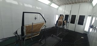

Yes I notice that the overflow tank is full.That is one 'full' overflow tank!
Will you be stripping the interior out completely?

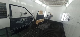

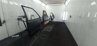

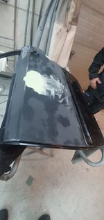

ThanksKudos to you Skikar, this looks like a proper repaint with doors and fenders deinstalled and not just a quick respray!
Are they also removing the glass? If they do then consider replacing the anodized trim pieces. I did that on my car and it looks so much nicer when the trim is dark and not shimmering in a silver/gold tone.
Excited to see how your car will turn out!
