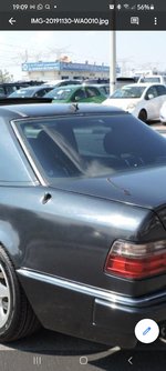

Hi
My car had telefon from the factory, I have found wiring under the driver seat but i missing the phone and phone holder in the armrest.
I have one speaker on dachbord right side But missing speaker left side?
I have aftermarket speakers in frontdoors
Mercedes speakers in behind the headrest bout side's
I have antenna on roof is the from factory?
Does anyone know how the phone looks like and the part nr or can I find the phone in other Mercedes models
270ANTENNA WITH SPLITTER ON REAR LEFT FENDER (REAR RIGHT FENDER OF S/V 124) AND LOUDSPEAKER FOR D-NETWORK TELEPHONE
274MERCEDES-BENZ D-NETWORK TELEPHONE

I believe only the driver's side of the dashboard had the special speaker with a dual-voice coil that was used together with the mobular telephone system.
I am not 100% sure what the non-US phone looked like that went in the E500E, but seeing as I am the only person here on the forum who knows how to use the "search" function, here are a few threads that contain photos of & info on the factory mobular phones that may be helpful:
