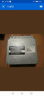

Hi
Can I use these ecu in my car
engine ecu 0155453632 does the engine get more Hk 326HK 480NM ??
what can i pay for something like that package price
90185778_306665846975349_5845409928184856576_n.jpgWith this
The modules (and EZL) in that photo are all correct spares for your car. The 015- ECU does not have WOT enrichment, if that is what you are asking.
What is the asking price for the set of modules?
Sorry for my English
My car is 1994 and the engine power is 320 hk
Can I used this ecu in pictures and get 6 more Hk??
What is WOT enrichment
I don't know about price yet
My car is 1994 and the engine power is 320 hk Can I used this ecu in pictures and get 6 more Hk??
No. Your LH module with 016- part number, and the 015- module for sale in the photos, will both produce the same power.
Early LH modules go into "open loop" model at full throttle (WOT), which gives a power gain. The USA SAE power ratings were 322hp in 1992, and 315hp in 1993-up, giving the impression there is a 7hp (SAE) difference. However, there were MANY mechanical changes between 1992 and 1993 (USA model years) also partly responsible for the power change, besides the loss of WOT enrichment as of 1993 (again USA). Bottom line, your 1994 vehicle would need a different (older) LH module to get the power gain, which would be more than 7hp / 6hk.

I get the price for all the parts shown in all pictures 1400 dollars

I found this Ecu in usa
Can I used this ecu in my car Euro 1994 model with catalysts system
And get more Hk and gain?
In the usa, yes that would be a small boost to power in a 93-94, but I am sure GSXR will know that for sure if there was a EU change. Not sure it is noticeable, for normal driving for me anyway but I run that model year unit in my 5/1994.
Again, this reference should tell you what you need to know for the ECUs:
That is an early ECU that is appropriate for the 500E/E500, and can be used with the later cars. It has the "WOT" enhancement for the extra power, when used with a later car. As has been said, there is around 10-12 extra HP, but this is only observed/avaialble at Wide-Open-Throttle (hence the WOT), and even then is not really noticeable. You will see zero difference in any day to day driving.
Ditto what Gerry said: ^^^
Note that if the seller hasn't specifically tested for the clicking fuel pump relay, you'd need to do that, and if it clicks the capacitors need replacement.
