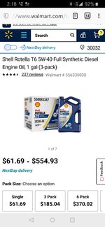

I asked because I followed the link and it shows $61.00
Ahh, they must have raised the price. Probably because they're shipping in huge boxes
