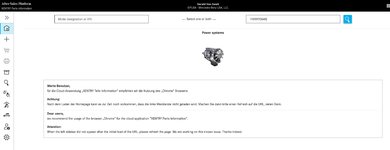

Then, select the "Search" menu at the top of the screen, as shown below. There is no need to enter any vehicle-specific or VIN information into the EPC. From there, make sure you are on the "Part without vehicle data" tab of the search window that pops up. It should be pre-populated with an "A" in the search box when you select this tab.
Enter the part number, with no spaces, directly after the "A" in the search box, as shown below.
Click the [ENTER] key to commence the search. A list of various applications for the part number across various engines and chassis will show up, as below.

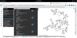

Upon doing this, you will see a list of applications of this part number on the selected engine/chassis. This list will show the systems where this part number is used. Select the desired system, as shown in the list below.
After clicking [ENTER] again, to select the desired application, you will be shown an exploded parts diagram and part number information for what you are looking for, as below.
