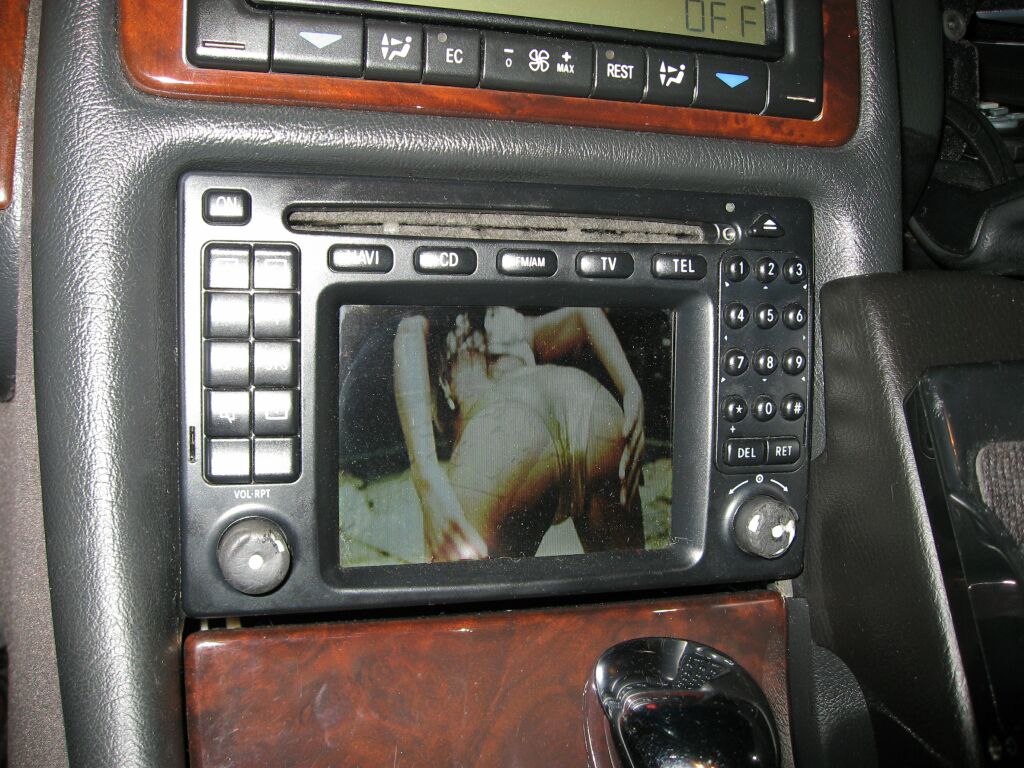

Comand = Cockpit management and display.
Its the Navigation+Radio+TV+CD unit from newer MBs, I think the one used here is either a W203 or a similar system from Becker or VDO Siemens.
I don't think its too difficult as the wiring on these systems are similar to the late W124 cars. There are Units that don't use D2B connections.

The Comand would need to be a non-canbus Comand, so probably its from a 98-99 W210. Definately not a W203 unit
These have been retro fitted to W201's, W124's, W202's etc. The nice retro fit is the W202, where you also retrofit the dash cluster (from W208) and the 2000 steering wheel with Coman controls. Very nice but a total PITA.
Cost wise and time wise, you would be better off getting a aftermarket nav system (better anyway)
I had a Euro Comand in my CLK32k with the euro TV tuner. Used the aux inputs of the tuner to feed a signal from my trunk mounted DVD changer.

I have been looking at retrofitting a 2 DIN Nav + Ent. system, but I didn't like the solutions for the aftermarket units with large screens that flip outwards.
This may be what I'm looking for.
Will the North American units take iPods, Bluetooth, play DVD's and run a camera? Or are these systems too old for that?

Personally, I wouldn't go that route. The older Comand is not that great and the amount of work needed to install a double din isn't worth it either.
If you do some searching, you can find more info about the install into the W124, here is just one thread
http://www.mbworld.org/forums/e-class-w ... -w124.html
My CLK32k came with Comand, otherwise I would of went with a single din unit w/flip out screen. I don't run this type of setup in my 500e because the NAV units don't have the amount of DSP processing that I want, so I use the head that I want and a TomTom when needed.
On that note, there are NAV units built into rear view mirrors, very slick looking! Once I find one that can be modified to fit into the W124, I will be all over it.
