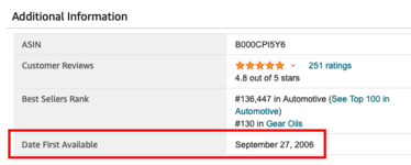

Ah, OK. I know Redline 75W90NS has been avail on Amazon since 2006 .... I was just curious if you had tried it and rejected it for whatever reason since you use Redline motor oils......
I must have missed it for some reason - I can't recall why. But otherwise, I would have no problems using Red Line NS. I'd still prefer the Motul for easy of pouring despite the higher cost, but that is the only reason.
