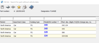

I'm formulating a dumb idea. I'm guessing my S500 has a 4 arm differential input flange, meaning I should be able to harvest that flange and get my 3.06 diff ready to go. I wonder if I could get away with taking the car to the track, laying down a baseline time, and then swapping the diff in the pits and running again later in the day.
Problem: The 140 chassis with 5L and 6L engines use a "reinforced" differential that has a lot of different parts, including a different 4-arm input flange. The part number is not the same, and I have a feeling it won't fit your 3.06 diff... possibly the pinion is larger diameter on your S500. If you want to prep the 3.06 diff ahead of time, you'd need to source the matching part number flange (126-350-16-45), see EPC screenshot below for potential donor chassis. Slim pickins... early 129 or a 140 with 4.2L, or another 034/036.
