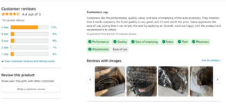

Looks like the big 20-gallon unit has very few reviews, because so few people buy the Big Boy. The one 4-star review was griping about the lack of adapters, no JLR adapter (in JD's defence, no other extractor includes this either - it's a factory JLR tool/adapter). The lone 1-star review could have been user error, there are a bunch of valves which must be set properly for the unit to work. The claim of no customer support could also be user error, I'm not sure.
The smaller 6-gallon unit has almost 200 reviews, overall they are positive, 4.4 out of 5 stars:
https://www.amazon.com/JohnDow-Industries-JDI-6EV-Gallon-Evacuator/dp/B000P6WQ6A#customerReviews
