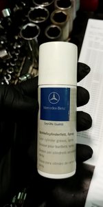

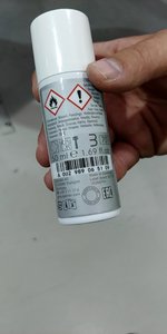

Dang it! I literally just got ahold of it and took pictures. We ordered another from Germany. We'll see when it gets here.
Are those photos of a recent can you just purchased? Or old stock?

I put two bottles of 002 989 06 51 09 onto my most recent parts order. This is the lock lubricant.

The Mercedes lock cylinder grease spray just came in on my latest parts order. I ordered two cans of it.
You hoarders should order up some for your chemical shelves.....

It's about $USD 12 my cost at the dealer. Not bad, really, for what it is. Nice can and spray setup, too.

I think the new gray-can stuff is coming out of the same factory, one labeled MB (post #33), the other VW (p/n G052778A2, post #25).
