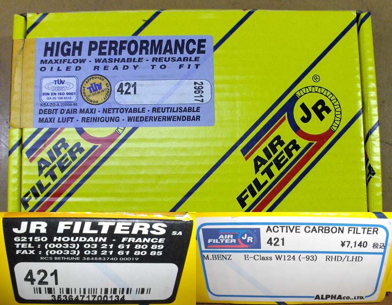

Postby gsxr on Sun Feb 15, 2009 6:36 pm
Rik, I really don't recommend trying to retrofit the 94-95 filters on to a 86-93 vehicle. When installed as shown in that Japanese document on your website, it will interfere with the main air flap (not allow it to close all the way). I tried this once, applying vacuum to both chambers of the main air flap pods, to see the flap fully closed (wish I had taken photos). That's why MB had to fully re-design the entire heater box, including making the fan cages smaller, to allow room for the filters above the box.
Instead, I would recommend the JR Fitler solution, which mounts externally. It's a little more expensive but probably works equally as well, and only requires a fraction of the effort. I have these on my two pre-94 cars:

Postby 195910 on Sun Feb 15, 2009 8:01 pm
Hi Dave.
Could you please provide more info regarding these filters (supplier, price , fitting instruction, how well they work)?
Do they fit behind the little black grill, or on top of them ?

Mercedes used a solution of this type (Dave's filters) as early as the 1960s on the W111/112 and W108/109 cars.

I didn't have any problems with the filters or clearance or any functionality problems.
I do like the JR filters, they are just impossible to find and too expensive.

Postby 195910 on Mon Feb 16, 2009 6:11 pm
I found the JR filters website, French company, Might give them a call to as about distributors.
Did you buy them from japan ?

Postby gsxr on Tue Feb 17, 2009 4:52 am
2phast wrote: I didn't have any problems with the filters or clearance or any functionality problems.
Well sure, but you also didn't apply vacuum to both ports on the main air flaps with everything taken apart to observe the operation before & after installing the filter - now did you?
2phast wrote:I do like the JR filters, they are just impossible to find and too expensive.
You can buy direct from JR, but yes, they are expensive.
Postby gsxr on Tue Feb 17, 2009 4:55 am
195910 wrote:Could you please provide more info regarding these filters (supplier, price , fitting instruction, how well they work)? Do they fit behind the little black grill, or on top of them?
They snap in place over the black plastic inlet. They work fairly well, AFAICT... they get dirty, which I suppose means they're doing something, and keeping dirt out of the evaporator. You can buy them direct from JR in France, but they're not cheap. It's probably better to buy 5 or 10 and then re-sell the extras to your MB buddies to offset the cost of wire transfer payment, etc. They are small & light so the shipping cost is almost the same for 1 or 10:
From: INFO JR <info@jrfilters.com>
Hello
We have no distributor in the USA.
We can send the filter directly to you.
Filter #421 is 34.00 euros.
+ sending cost of 21.00 euros.
Best regards
Corinne Barthod

Thanks for the info. I'll try contact them, to see if they have a distributor in our area or in europe (other than France).
Might be able to find it cheaper.

Postby Glen on Sun May 03, 2009 3:55 pm
What do you mean your cabin steams up? Is the a/c on or off?
I don't know if the JR filters have charcoal or not, if they do then they filter dust and odor, if not, then only dust.
Postby Chappardababbar on Sun May 03, 2009 4:08 pm
Glen wrote:What do you mean your cabin steams up? Is the a/c on or off?
Thanks - I think I'll get a set.
What I mean is, as soon as it drops below about 10 degrees celcius, when I have my windows up and A/C off, the windows steam up very quickly. By that I mean I wouldn't be able to see anything within 10 minutes. Also, I start to get condensation between the two pieces of glass of the rear window.
Chappardababbar
Postby Glen on Sun May 03, 2009 4:22 pm
At that temp, the a/c should dry the air enough inside the car to keep the windows clear. What happens when you use defrost mode?
Postby Chappardababbar on Sun May 03, 2009 4:45 pm
Glen wrote:At that temp, the a/c should dry the air enough inside the car to keep the windows clear. What happens when you use defrost mode?
What I mean is the windows steam up WITHOUT a/c. As soon as I put the a/c on it clears everything up nicely. When I drive my dad's Honda in the same weather conditions, the car does not require the a/c to be on as there is no condensation. It's not such a big deal.
I don't think I have the defrost a/c mode as I have the twin dual zone dials. If you're referring to rear window defrost then that doesn't work on my car. I just get one feeble little clear line across the middle about 1cm in width. Does the whole rear window need to be replaced to get this to work again?
Chappardababbar
Postby Glen on Sun May 03, 2009 7:48 pm
Oh, I understand now. To minimize condensation on the inside without using a/c, make sure you are using fresh outside air, do not use the recirculation mode. You may also want to vent the sunroof or lower a couple windows just a bit. The reason for the condensation is the drastic differential in temperature between the cabin and outside. Once those equalize, your windows should stay clear.
