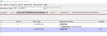

Mahle/Behr CR282000P (shown in your photo) crosses to Mercedes 1245003103 / 1245000002, which fits the 124.133/.193 six-cylinder turbodiesels. Note the ATF cooler fittings may be different, and there may not be an aeration fitting at the top of the radiator either.

CR282000P is not for the 400E/500E, it's for different 124 chassis. See post #104 above (click here) with details.
CR283000P fits the 400E/500E (124.034/.036) but is NLA.
