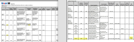

FYI. Mobil, as of May 2022, has reformulated many of their Mobil-1 viscosities to conform to GF6A to combat turbocharger-induced low speed preignition.
Mobil-1 15W-50 seem to have been unaffected --- still at 1200/1300 Phosphorous/Zinc but now with SN+ rather than just SN approval from 2018
Mobil-1 10w-40 seems to have gone from 800/900 P/Z to 800/870 P/Z (and no GF6A)
Mobil-1 FS 0w-40 also seems untouched:

Here is Mobil-1 product information on ZDDP/Phosphorous in pdf format from the following years that Mobil released this info:
  • 2009
  • 2010
  • 2011
  • 2013
  • 2014
  • 2016
  • 2018
  • 2019
  • 2022
for archival purposes. You can see that Mobil-1 15W-50 has stayed the same through all these years for ZDDP / Phosphorous, whereas "Extended Performance" and other lines' / weights' concentrations have changed over time.
