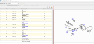

The car will still have the original wiring harness, it's part of the windshield washer system. You will need to wait until you receive the car to determine what components are missing. However, the main items would be the wiper motors, arms, and blades... some of which are NLA.
Part numbers below. All this stuff is likely missing since the car had the wipers deleted. Ignore callout #19, it comes with the arm #17 if buying new. If buying used, you'll need to see if nozzle #19 is intact or not.
You also will need the wiper panels, A1248890763 and A1248890863.

Wiper blades and wiper arms are very likely NLA, but I'm sure you'll be able to find them as a NOS item on ebay (I did with mine 2 years ago).

I got a quote from Mercedes Dealer based on the list of Dave.
This are the parts available at Mercedes desk
It is just a quote to know which parts are available.
Regards
René
Yep, that's what I expected. Both motors, one arm, zero blades.
