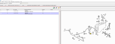

Can someone with EPC or ISPPI confirm if the PN that DuhVinci lists is correct for the 036? I'm about to replace the reservoir and figure I should replace everything else with it (pumps and rubber parts)
Screenshot below, grommet p/n 123-997-36-81, qty 2 for the pumps:
I'm considering doing the headlight wiper delete, so back to the same subject of washer tank plugs:
With the wiper delete, the second pump will be removed. And there is a factory MB plug/grommet to go in it's place. That is how late models of R129 came with if were equipped with factory xenon light. I'm not finding that filler grommet plug on any diagram. @gerryvz and @gsxr any chance your systems show that little filler plug or you know the part number (this diagram for the cars with headlight washer system, #200 will be removed, and the grommet #205 to be replaces with the plug instead.)?
EDIT: Is it A 00 099 733 20 by chance?
Thank you kind Sir! Now I have to "borrow" the VIN number from Xenon fitted car so I can order under headlight trim pieces without the holes from the dealership...
