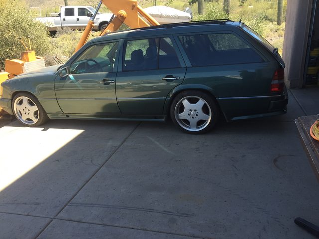

Here is the car a few days after he got it, it came with the staggered AMG wheels pictured in addition to the AMG side skirts/bumper and Lorinser springs.

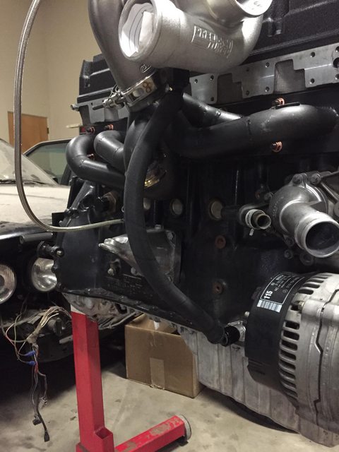

Turbo feed and return lines
What oil supply line adapter did you use on that bubble flare fitting from the block?
Thanks,
Karl
