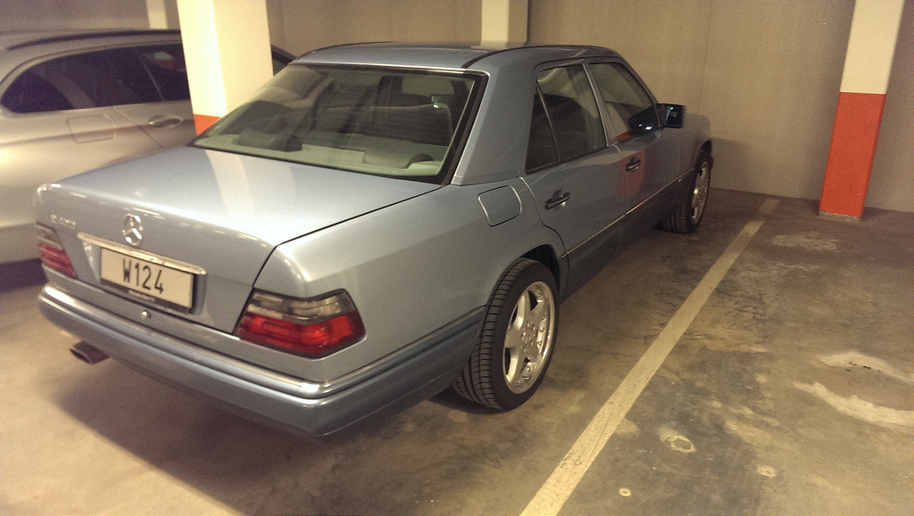

After Sportline, it has set quite a bit now. :)
Had to get a vanity plate.

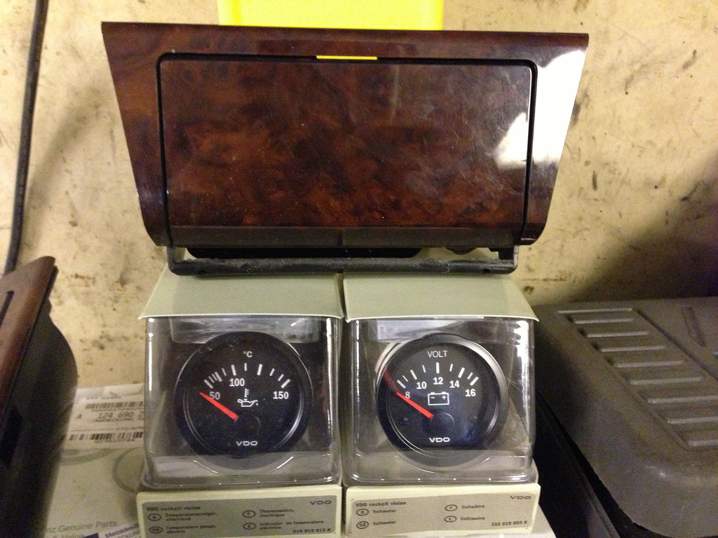

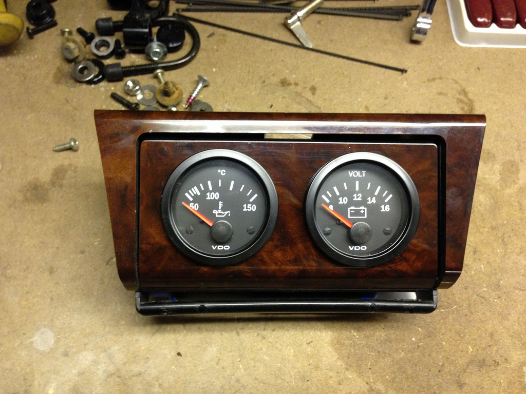

Last year I started a project to add a volt meter and oil temp guage in the ashtray. Tried like hell to get the Brabus Tempamatic kit but it's near impossible.
I'm using VDO Vision guages, they are very similar to the original cluster design (also made by VDO):
Guages and an ashtray assembly from our spares car, keeping the original ashtray intact.
Wiring left, and securing/fitting the ashtray in the compartment. I'm using a VDO sensor in the oil drain plug.

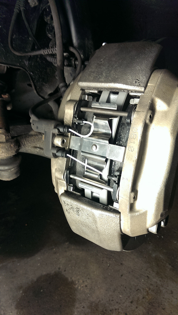

Started with the SA kit the other day:

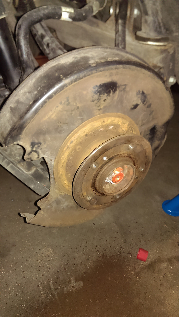

The parking brake was in dire need of a rebuild:

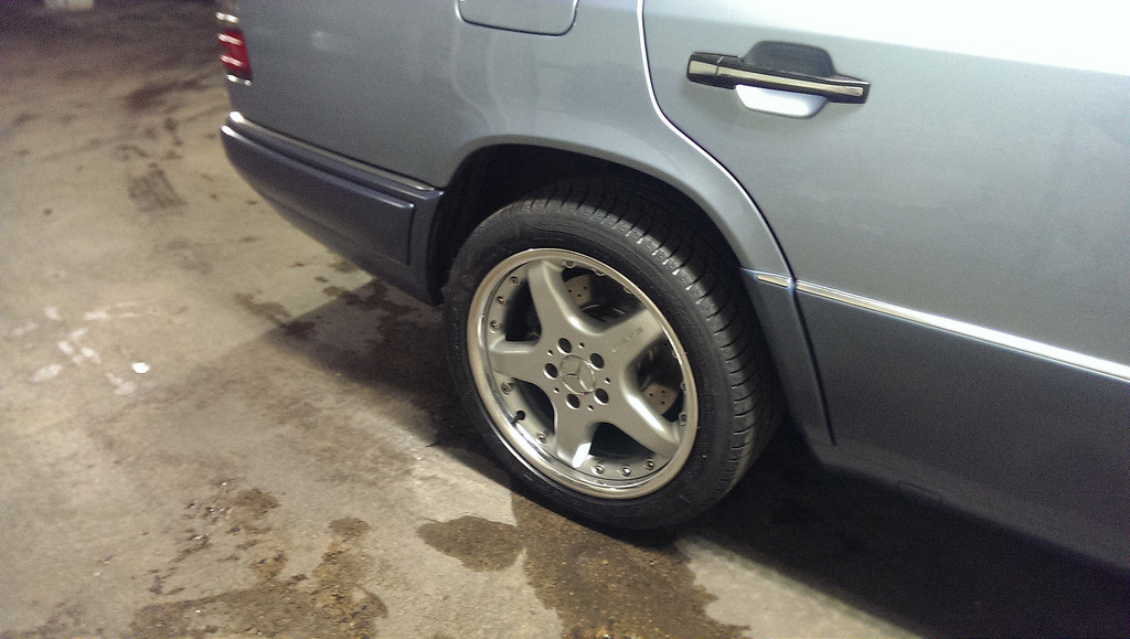

So now I'm eagerly waiting for my new tires to arrive, Michelin Primacy HP. Tomorrow I'll finish the brake job and a few other odds and ends, then it's time for a MOT.
Work with the SA-kit complete bar the braided hoses that will be fitted in the winter.
Springmeet in Sweden:
A tad to wide in the rear, no scraping though. Perhaps I'll have to massage that fender lip a bit:

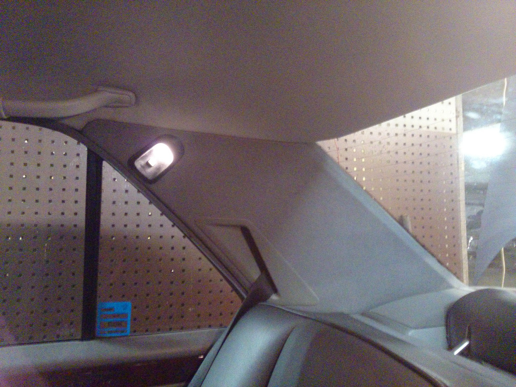

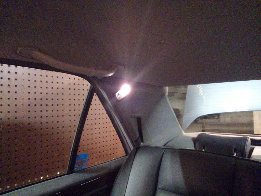

I'm adding what I call "W124 illumination package" to my car, consisting of door courtesy lights, illuminated sun visors and rear reading lights. Started on the rear reading lights today, I ordered the cable harness for it a year ago, it was a shockingly inexpensive $20, stunned that it was available too. Not an issue if it hadn't been, but still.
Checked the wiring, and removed the plastic cladding off the c-pillars. No broken clips!:
I was under the impression that Mercedes didn't put any markings on the backside of the c-pillar cladding, I've read it several places methinks, but to my joy they are marked, albeit very lightly. Enough to make out in good lighting, after that I applied drill and saw:
Not too visible markings, but they're there:
Reading light in place:
One side finished, one to go, then I have to thread the cable harness through the headliner, and reattach everything.
Reading lights done! Not fun at all with the headliner and the wiring, but I sorted it. Also I discovered that my panels do have broken clips. :( But I managed to get the panels in place ok, maybe I'll repair them later, there's an excellent guide here on the boards.
