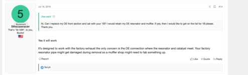

I thought in the 2019 thread that the Fleiben front section and [catalysts or testpipe] were supposed to work with the factory resonator and rear exhaust ----
Here from the 2019 thread: Post #14
Same. Otherwise, why would anyone buy just a front section? Unless they were planning on having a custom resonator/muffler made that wasn't flieben
