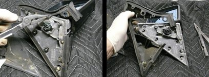

With my door mirror interior trim plates removed for repairs, I took the opportunity to replace an original door mirror rubber boot that was petrifying & beginning to crack.
A suitable replacement part had been previously liberated from the local junkyard. The following method worked very well for me.
Removal:
  • Remove the door mirror according to FSM 88-905 B.
  • Take the mirror to a work area covered by a mover’s blanket or similar soft material to protect paint finish & mirror glass.
  • Carefully remove the triangular rubber gasket off the frame hooks which hold it in place. Clean & reuse this part if it is still in good condition. The boot uses these same hooks. Detach boot from hooks.
If the boot is petrified enough, you can break it off in your hands. Or it can be cut off. The least amount of material to cut thru exists near the bottom corner drain hole. Cut from each side into the drain hole then separate & pull the boot off the frame with a pair of pliers.
Take this opportunity to thoroughly lubricate any of the mirror frame’s moving parts. Also spray the electrical connection with contact cleaner & remove any corrosion which may exist.

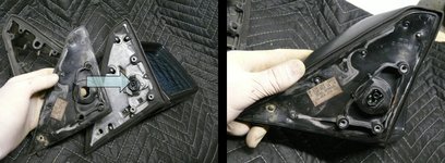

Assembly:
I used the J.M van Swaay method of immersing the new boot in a bucket of very hot water while I removed the old boot & prepared for its replacement. This method uniformly heats the entire boot to maintain the flexibility required for reassembly. I also had a heat gun at the ready just incase, but it was unnecessary.
  • Fit the pointy corner of the mirror mounting frame thru the smaller boot hole. Pull the point thru the hole & over the boot corner that it will eventually fit into.
  • Fit & seat the smaller hole portion of the boot that rests adjacent to the mirror.
  • Now use a non-metallic body trim removal tool or equivalent to stretch/lever the boot over the pointy frame corner.
  • Reattach boot to frame hooks.
  • Reattach triangular rubber gasket to frame hooks.
Prior to door reattachment:
  • Thoroughly wipe down the boot with a UV protectant
  • Apply some dielectric grease to the electrical connection & never-seize to the mounting screw threads.
  • Clean & wax the outer door skin that the mirror will cover. :checkeredflag: :e500launch:
