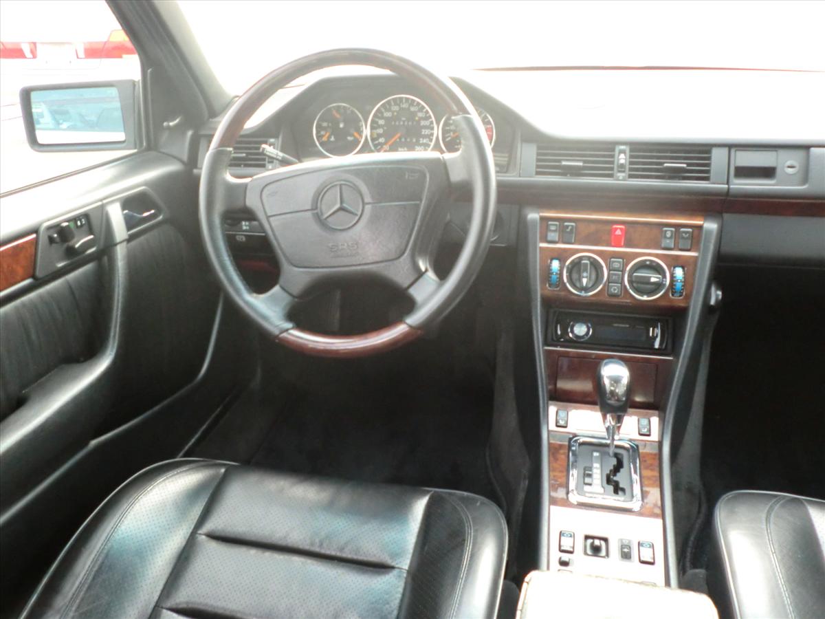

I think I've said I'm not big on Red exterior, but this is gorgeous, JLAA Excellent job on all of the restoration, and I really appreciate the detailed pics.I used Gorilla Glue to glue back some of the vinyl along the driver's door pocket. It seems to work well.
I put thread locker on the nuts for that hold the wood to the door --- one of the nuts had come loose.
At the same time, I repaired some cracks in the base plastic of the fragile interior A-pillar triangle cover with JB weld --- that made the triangle stiff again.
The only thing I've found with my new 124 is that the upolstery is pulling away from the door side pockets. Very helpful to see how you addresed the issue.
