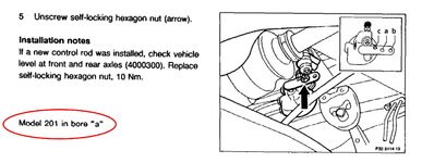

Tacking this question on here for future benefit.
Has anyone used the second inboard hole on the SLS connecting arm (the arm on the valve itself)? It is in more vertical alignment with the sway bar arm and I'm wondering what the small decrease in leverage will do. Seems to me the change would make the system more sensitive. Just curious as I'm reassembling this after compehensive work at the rear.
Drew,
Per the FSM is bore "a" on the pivot used for the W201.
I think the same SLS valve is used on the 210 models having a different linkage, and it appears that bore "a" is utilized as a guide hole for the linkage.
