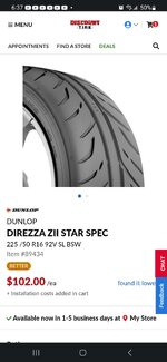

Yeah, I'm definitely noticing that it's hard to find performance tires in the 225 or 215 sizes. 205s can be found all day long. I'm kind of eyeing these Firestone Indy 500s. This is of course the $400 400E, so trying to keep things cheap. After rebates and such, a set of 4 is $422. My biggest concern with a high performance summer tire is that with the soft compounds I'll just turn them to smoke with the 5 liter and 3.06 gears. That's why I was also wanting to maximize tread width.
I actually went down to Discount Tire this afternoon to order some Dunlop Direzza ZIIs in 225/50/16, but alas, they have none available despite the website claiming they do.
I guess another option would be something like a 205 in the front and a 225 in the rear. A little weird to do staggered tires and not wheels, but 🤷‍♂️

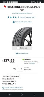

I know the consensus was that the 16x7 was too narrow for a 225/50/16, but I decided the give it a shot anyway. Many BMW E36 and E46 sport models came with 16x7 and 225/50/16 from the factory, so I figure it can't be that bad.
I ordered the Firestone Firehawk Indy 500 set from Tire Rack. They just arrived today. I've never run them before, but I've heard lots of good things and the price was great, so I guess we'll see.

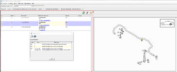

Cory, do you know the diameter of the 210 wagon rear bar? And if it has a similar shape as the E55 rear bar?
I'm seeing 210-326-22-65 as the wagon rear bar p/n but it's NLA per MB Classic (link). There appears to be a Sport package version that should be larger diameter, 210-326-23-65, also NLA, also unknown diameter. I found unconfirmed data showing 18mm standard 210 rear, 20mm "Sport" 210 rear. The V8 wagons used 210-326-23-65 as standard rear bar, and 210-326-24-65 for Sports chassis rear bar.
There's an E50/E60 rear bar too, HWA-210-326-01-65! And, of course, also NLA (link).
Pity all the W210 rear bars are NLA too. 😡
