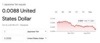

① Size Front 18 × 8.5 +23 5/112 Unit price ¥ 85,360 × 2 = Subtotal ¥ 170,720
② Rear 18 × 9.5 +25 5/112 Unit price ¥ 87,120 × 2 = Subtotal ¥ 174,240
③ Fastening bolt M12 x P1.5 60/27 Unit price ¥ 693 x 20 = Subtotal ¥ 13,860
④ Shipping: Japan → United States Unit price ¥ 22,000 x 4 = Subtotal ¥ 88,000
① Subtotal + ② Subtotal + ③ Subtotal + ④ Subtotal = Total ¥ 446,820 [~$3900 USD]
Please make the transfer in Japanese Yen
Use airmail for transportation
Will be delivered to your home
