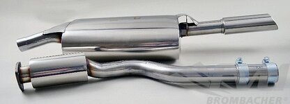

Got the itch up my ass... browsing internet for car parts never "ends well" for the wallet...
Dansk stainless exhaust being shipped, got a very very good deal on it...

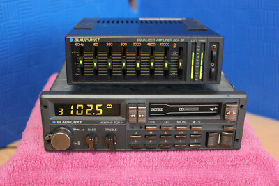

Going to revert back to single din, really not liking the double din prior owner installed. Too big for this car, too bulky, too bright... So I've obtained the the factory pocket and the center console trim to replace the modified one currently in the car.
I've also found the "spare" head unit from 2-3 years ago, has DTA, x-over, EQ, 4V and 6-ch output along with unlimited illumination options (so I can match the red of the dash), it would all look better esthetically imo...

P.S. Dansk stainless exhaust came in today and DP Motorsport springs are on their way, were shipped today directly from Germany :jono:
I totally agree, double DINs look so clunky in these cars and kinda Euro trashy. They also don't fall to hand at all. Mine had the BEA80 deleted and while I loved the cubby that replaced it, if I could go back I'd add another. Would you? They look sooooooo coool. I'm sure you can get just the amp for <$100, and maybe even change the LEDs to be orange and not green.
I love those old school units! And I do miss changing the sound/adjusting EQ on the fly, so this combo does look tempting... But my brain is wired for to have some of the modern tech "needs", particularly DTA for me is kinda a "must" for fine tuning imaging and staging. For EQ, I would consider getting one, need to look around...
I did remove the double din today, soooooo glad to see that big bright blue thing gone! This old Kenwood would do for now.

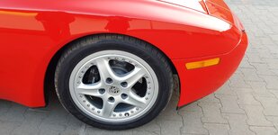

Learned something new about these cars every day... "Caster Block" - apparently it is a weak spot if updated wheels to a larger size, and these would have to be upgraded to a 968 units of an aftermarket improved part. Basically too much of a rubber compound in the 944 factory part, too much flex. Upgrades and 968 pieces stiffer, more metal and less rubber. So I ended up getting a set from elephantracing.com
Basic instructions with the torque specs at Control Arm Replacement 46Nm bolts to body, and 100Nm for eccentric nut. Ok, so more to do this weekend. Will also try to take a whack at installing cat-back stainless Dansk exhaust.

A little more progress today...
Caster Blocks replaced
There is definitely a difference between the 30+ years old stock and the upgraded pieces, a lot less rubber

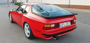

Removed stock and replaced with cat-back Dansk stainless system
Does not stick out far, kinda factory look
Not loud, not obnoxious, just right I think...
I'm not good at these video clips, so here is one from S2 with Dansk, driving... (wish they'd tone down the music though)

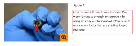

After close inspection, while for the first time under the rear of the car, both inner CV boots are ripped. Not certain how long have these been ripped and how much dirt got in the actual joints, will replace the inners and will re-boot/repack the outer while there... Lobro here we go
Going to clean up the factory bolt head really good, want to make sure no "strippiage" of these 8mm 12 point heads will occur and the head of the triple square tool will sit in really really well. I had my brother order a tool from Matco, can't find anything of good quality locally.
I have a feeling, by the time I'm done with this car, it will be as new mechanically! Good thing that the parts are affordable and DIY is a must for the upkeep (unless funds are not an issue at all)

I think the key is indeed to get them clean clean! Even on pelican tech articles, one head was stripped
So you can imagine my "slight apprehension" toward the subject, but all went smooth and despite the greasy mess, really really enjoyed rebuilding the axles, and absolutely happy with the decision on spending few extra dollars on all new bolts.
