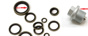

What a difference on the cold car!!! I knew I wanted to change all the fluids, including transaxle, and everyone has their preferences, so I read, and I read, and I read... until I found this post:
"I recently drained out my 3 year old Swepco 201 and replaced with 2 quarts Redline mt-90 and 1 quart redline 75-90ns. I read and read and read about these cold shifting issues I was having and downshifting not going into gears. It was clunk and go for a good 15 minutes every day til the car warmed up on Swepco.
I have to say the redline mix is like night and day over swepco. i can shift immediately on the first shift out of the garage and it glides into gear like knife through butter. I am truly amazed and have no idea why I waited this long with Swepco.
Originally I had put swepco in after reading about the rattling of the transaxle in drivethroughs while sitting still. It was very noisy and the swepco did an excellent job of quieting it down. But I simply felt like a handicapped driver everytime I would shift when cold. Had to double clutch it all the time and thought I better start saving some thousands for possible new tranny.
with the redline mix I went out at 25degrees F last week and shifted like never before. Also no more chatter in drivethru. Best of both worlds from my end and well worth it. Like a brand new tranny now on my S2
80 degrees this week and no chatter. All is good again. I now have a car that acts and drives like a Porsche!"
It's like someone is driving my S2, maybe not so extreme where I had to double clutch "every time" when it's cold, but certainly not what I thought it should have been.
FCP had all the fluids in stock, had transaxle plugs in stock, oil filters, oil plug and crush washers, surprisingly this order arrived with free shipping in 3 days! I wasn't expecting it until next week, but came home, and the box with surprise!!!
So onto 4 jack the car went, drained old fluid (wasn't horrible, but dark. I don't think it was 30+ years old, but certainly not fresh)... Changed the fluid, changed the oil (I did basic dino 15w40 leftover Delo, just for the short time, less than 500 miles, just to clean up everything) and now, fresh filter, plug and 15w50). Quite happy, car at the temperature, at idle and at 4 on the oil pressure. Full 5 while driving.
