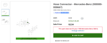

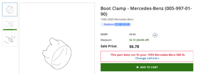

So I wanted to replace the valve cover gaskets on the SL and decided to check the PCV hoses before starting the job. Of course they were brittle, so I stopped and went ahead and ordered new hoses and clamps. At the same time I noticed the power steering S hose was leaking on the E420, so I added that to my order too.
I decided to go with MBdirectpars since they had better pricing. After I ordered the parts, they sent me an email and said the clamp for the S hose part # 005-997-27-90/000000-000948 and the clamp/loom tie for the PCV hose part # 126-997-06-90 are discontinued.
So I told them to remove those from the order and send the rest. I received the package today and I have a feeling that something is wrong!
For the clamp/ loom tie for the bigger PCV hose on the left valve cover, part # 117-997-01-90. They sent me 005-997-01-90, which is a totally different kind of clamp. But on their website it says 005-997-01-90 Replaces 117-997-01-90!
The clamp I received:
The clamp I needed:
Website:
Also for the power steering hose (Short hose under the reservoir) clamps part # 005-997-45-90, I received 000000-000667. These are much bigger than the actual clamps on the car! But again on their website it says 000000-000667 Replaces 005-997-45-90!
Diameter of 000000-000667 is 36mm.
Diameter of 005-997-45-90 is 26mm.
The clamp I needed:
Website:
So what do you guys think?
Their website is likely showing the Paragon data, which is the MB dealer part inventory system. Sometimes the replacement part number is functionally equivalent, for example the PVC hose clamp, if the size is correct the worm-gear type should work ok in place of the spring type. For the P/S clamp, check the diameter needed for the hose. The clamp you received is marked 20-32mm range which may be acceptable.
That said, there are many "bad" part number rolls (supercessions) in Paragon, where the new/replacement part is not functionally equivalent. For example the M119 fan clutch bolt is NLA and the replacement part is a Torx head, not hex head. What's the problem with that? Well, the special tools used to remove the fan clutch only work with hex head bolts! Some bean counter thought that just having the size/thread/shape matching was ok, but it's not, in that particular case.
:oldman:
That said, there are many bad part number rolls (supercessions) in Paragon, where the new/replacement part is not functionally equivalent. For example the M119 fan clutch bolt is NLA and the replacement part is a Torx head, not hex head. Whats the problem with that? Well, the special tools used to remove the fan clutch only work with hex head bolts! Some bean counter thought that just having the size/thread/shape matching was ok, but its not, in that particular case.
:oldman:
Thank you, Dave!
Oh I see! As for the PVC, I'll just use the old spring clamp. Having the worm-gear type clamp there doesn't look right IMO.
For the PS clamp, the old one I have is marked 12-20mm range. New one is also wider!
If the original part number was 12-20 range, and the replacement is 20-32... that sure looks like a bad supercession. Shame on Mercedes, if this is accurate.
Shame on Mercedes indeed! They sent me a second order with "correct clamps" and when I checked them, guess what? They sent me the same wrong ones again! When I told them about it, the parts guy apologized and said he will personally buy me the correct ones and send them over. A month passed by and nothing happened. I emailed the parts guy and he said sorry looks like all they have is the wrong ones! So I told him its fine don't worry about it any more.
