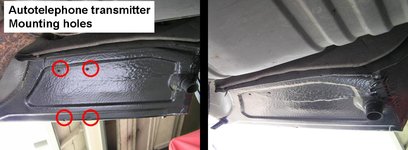

The first step of Job#1 requires removing the inner trunk fender well linings to expose the rear bumper mounting fasteners. I had a surprise discovery upon removal of the left lining which sidetracked me for a few days with additional work (which can be reviewed at this link):
http://500eboard.com/forums/showthread.php?1470-All-is-not-well-that-is-in-the-well

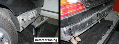

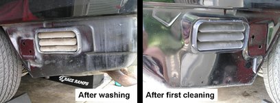

Job#2 is to inspect, wash & wax the newly exposed body area normally covered by the rear bumper. After washing the superficial dust & dirt away, the area was thoroughly wiped down with degreaser a few times.
I was real happy to discover the excellent condition of the under body & paint. The black paint was waxed twice with Zymöl. I intend to purchase & try out Turtle Wax Black Box for the next full body wax job. Black Box’s wax residue will be invisible on my car.

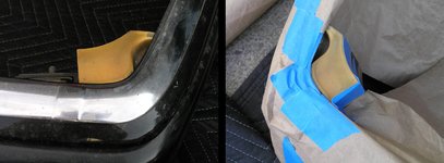

Job#4 is to paint the corner-mounted ugly yellow urethane bumper impact inserts (p/n 124 880 03 14). Although they don’t show much, they show enough to look like zits on the nose of the Prom Queen when contrasted against 040 Black paint.
• The rear bumper was placed on mover’s blankets. The areas to be painted were cleaned with rubbing alcohol.
• The surrounding areas were masked & protected from overspray.
• Several light coats of primer/sealer were applied.
• After the primer had sufficiently dried, several light coats of 040-type black paint were applied (I was painting the inserts flat black, but ran out of paint mid-way thru the job without a spare can on-hand).
The black painted inserts blend in adequately with the rest of their surroundings.
