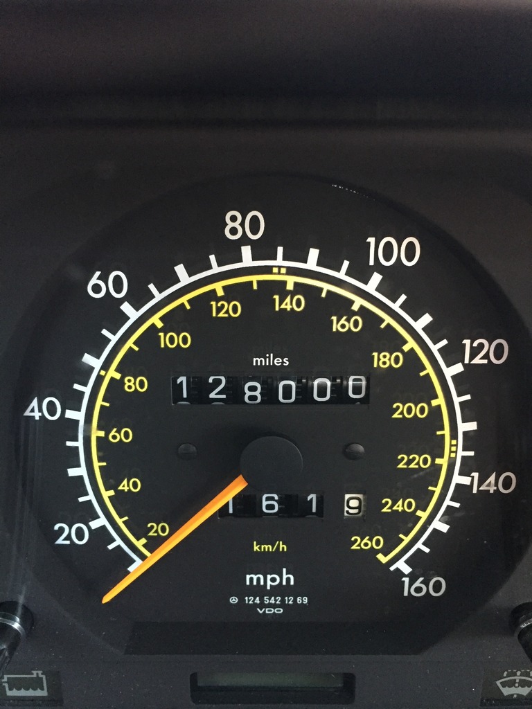

Had to head to the grocery store tonight, and rolled over:
I really love this car. Even around town. Hard to describe, but I'm a different kind of driver behind the wheel. It's nice and relaxed.
