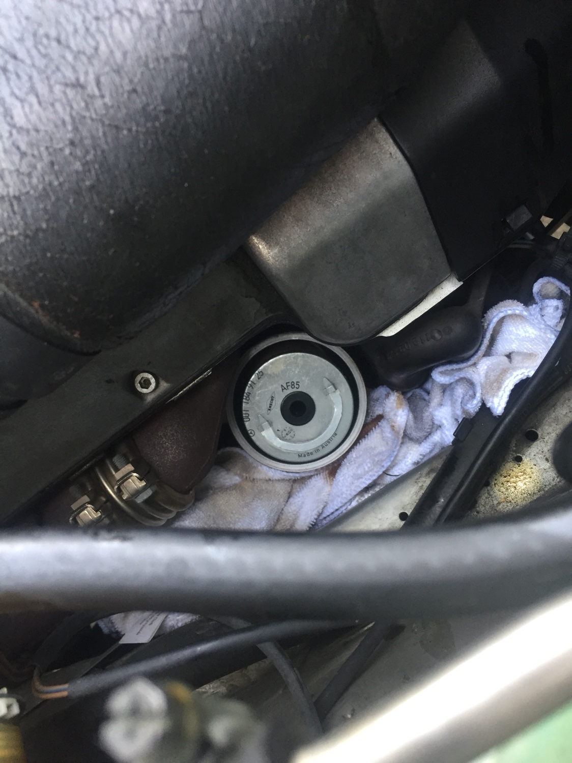

I had yet to change the oil since my purchase and it was due. I took yesterday afternoon to perform my first oil change! I found it quite straightforward. Awesome that the whole job can be completed with 1 8mm and 1 13mm socket! You can tell they were thinking about service when they designed this thing. Something i have never experienced with any wolfsburg or ingolstat product! A few photos, cause why not?

Tucked the rags in thanks to a gixxer pro-tip

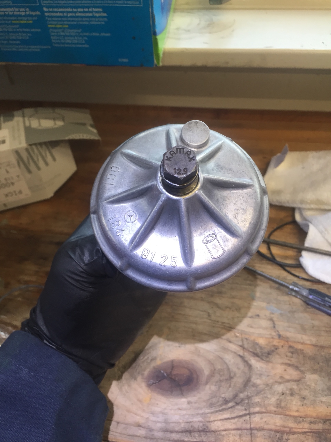

Popped the lid and took it into the garage for a clean up and to replace the gaskets
Then dropped in the new filter and all its austrian goodness:
Then drained the pan, switched out the copper washer, re-installed and dumped in 8 quarts of Castrol Syntec 5w-40. I plan on doing a 5k interval in this oil.
