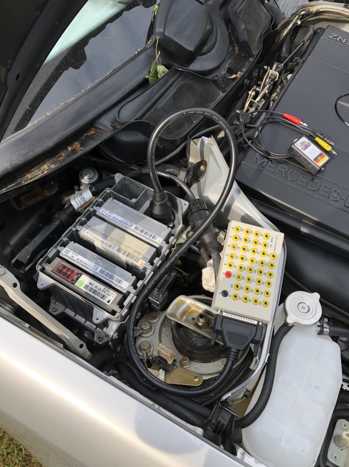

I'm very happy to report that Uter and I had a very productive evening together. First, I read off the codes! Here is what was there. Who knows how long they've been sitting in there
[TABLE="class: grid, width: 500, align: left"] [TR] [TD]Pin

[/TD] [/TR] [/TABLE] .
I got excited about the EZL ones, but then realized I had 'Klinked' my first startup by unplugging the CKP from the EZL to build oil pressure first. This is likely where these codes originated, since according to the documentation they are stored immediately. Since I don't know how old any of these are, I have no clue how pertinent they may be. I am curious what Pin 7, Code 11 is trying to tell me. What is the Fuel Safety shutoff for??
I cleared all the codes and then fired it up. It started just fine. I then used my mittivac to check the Air Intake plenum vacuum. It was pulling about -18 in Hg at idle. Does anyone know what the spec is for this? I figured comparing this number would be one way of looking for a vac leak.
I did notice something I found really interesting. I have been playing around with the air box off quite a bit. I had no idea how sensitive the engine was to disturbances in the air mass right above the MAF intake. You don't need to put your hand over the intake to get the engine to stumble. Waving your hand above the intake does it too!
I let it warm up while I looked up the codes I had just collected. It seemed to idle just fine. Warms up great too with the new Thermostat. Typically sits just a tick above 80 C. [emoji3]
After figuring out what the codes were. I shut it down, and checked the codes again. Nothing had popped up. I re-installed the cooling shroud, air intake ducts etc. In prep for a drive.
I hit the road! Drove great. No issues to report. Came back to the house, fiddled a bit with the Bowden adjustment and hit the road again. Again, no issues to report!
