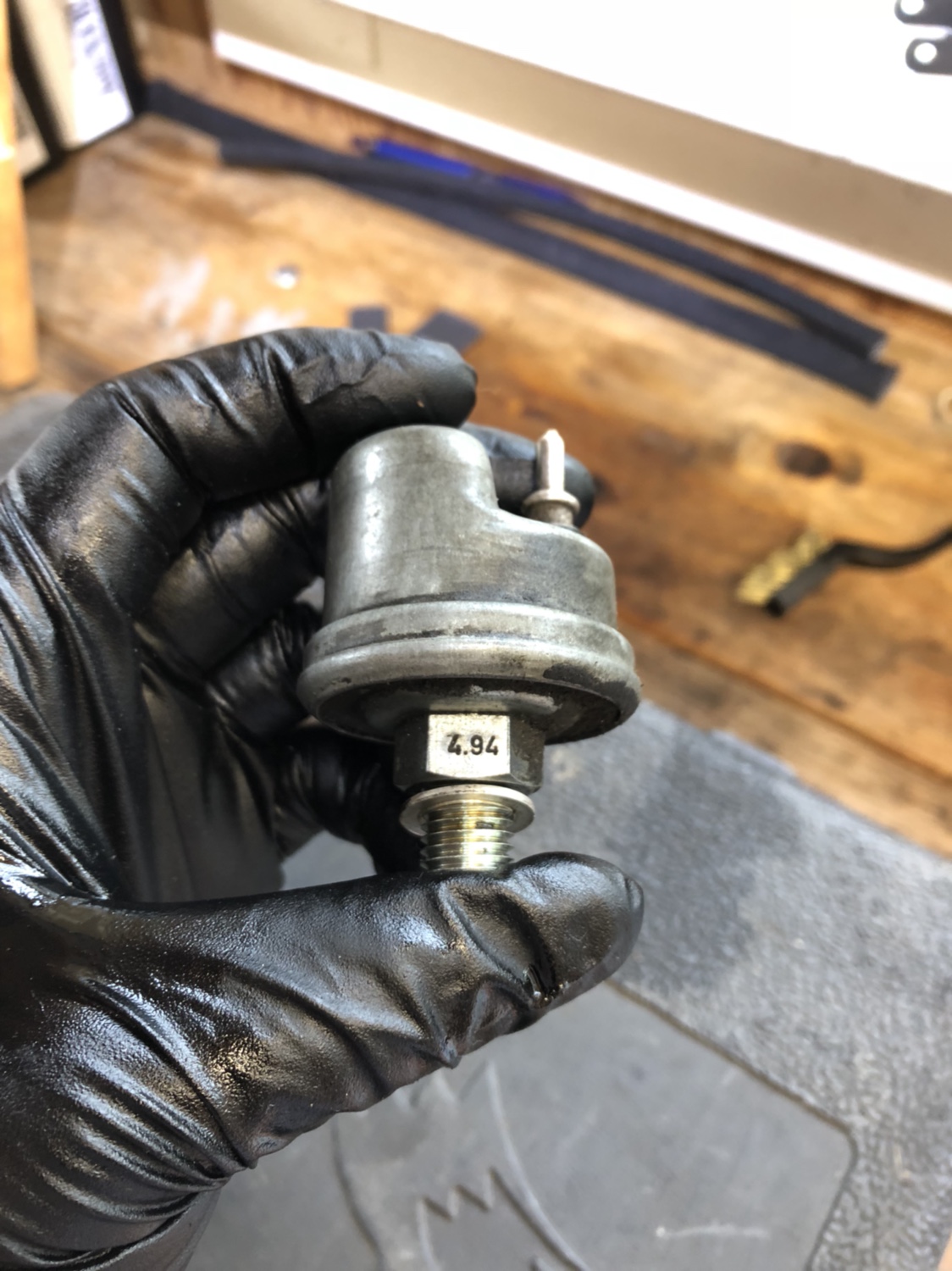

A new lower harness is in the works, so I replaced my oil pressure sender.
It was the original!
While I was under the car, i noticed that there is oil leaking down the passenger side of the engine from the air pump area. The intake hoses on the pump had a fair amount of oil, which had worked its way down onto the engine mount cooling pipes. The new valve cover gasket seems dry around the edges... is there anything over there that would leak? The air pump isn’t lubricated in any way, is it?
A new lower harness is in the works, so I replaced my oil pressure sender. It was the original!
Very common. I've replaced this sender on, I believe, every single car I currently own. They're usually toast by now.

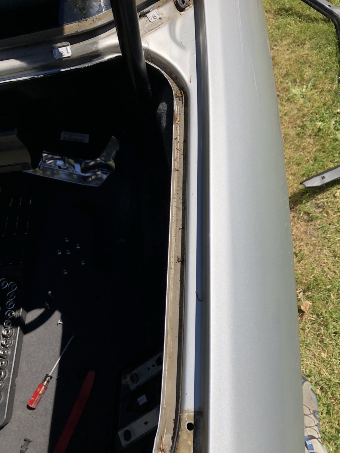

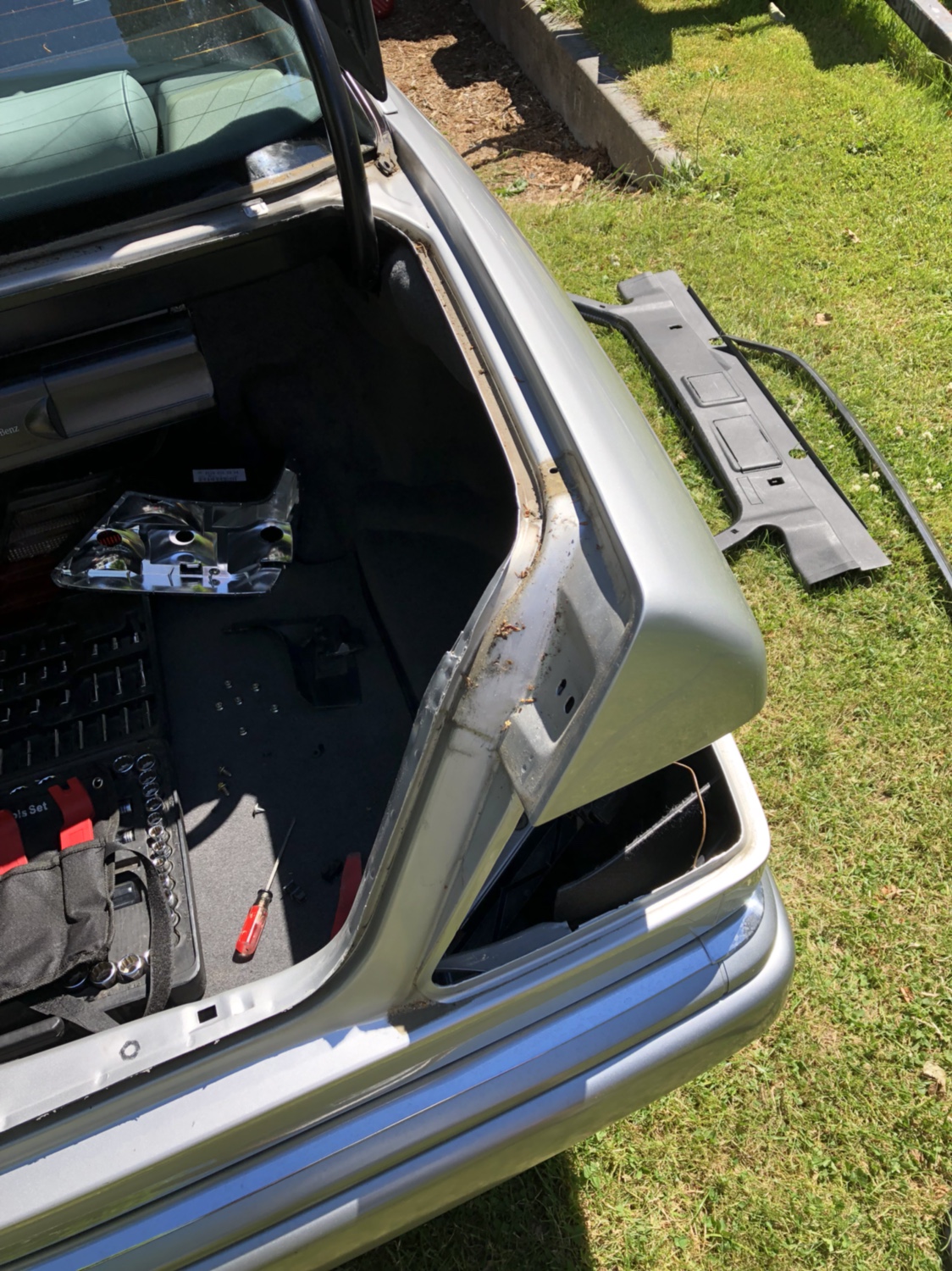

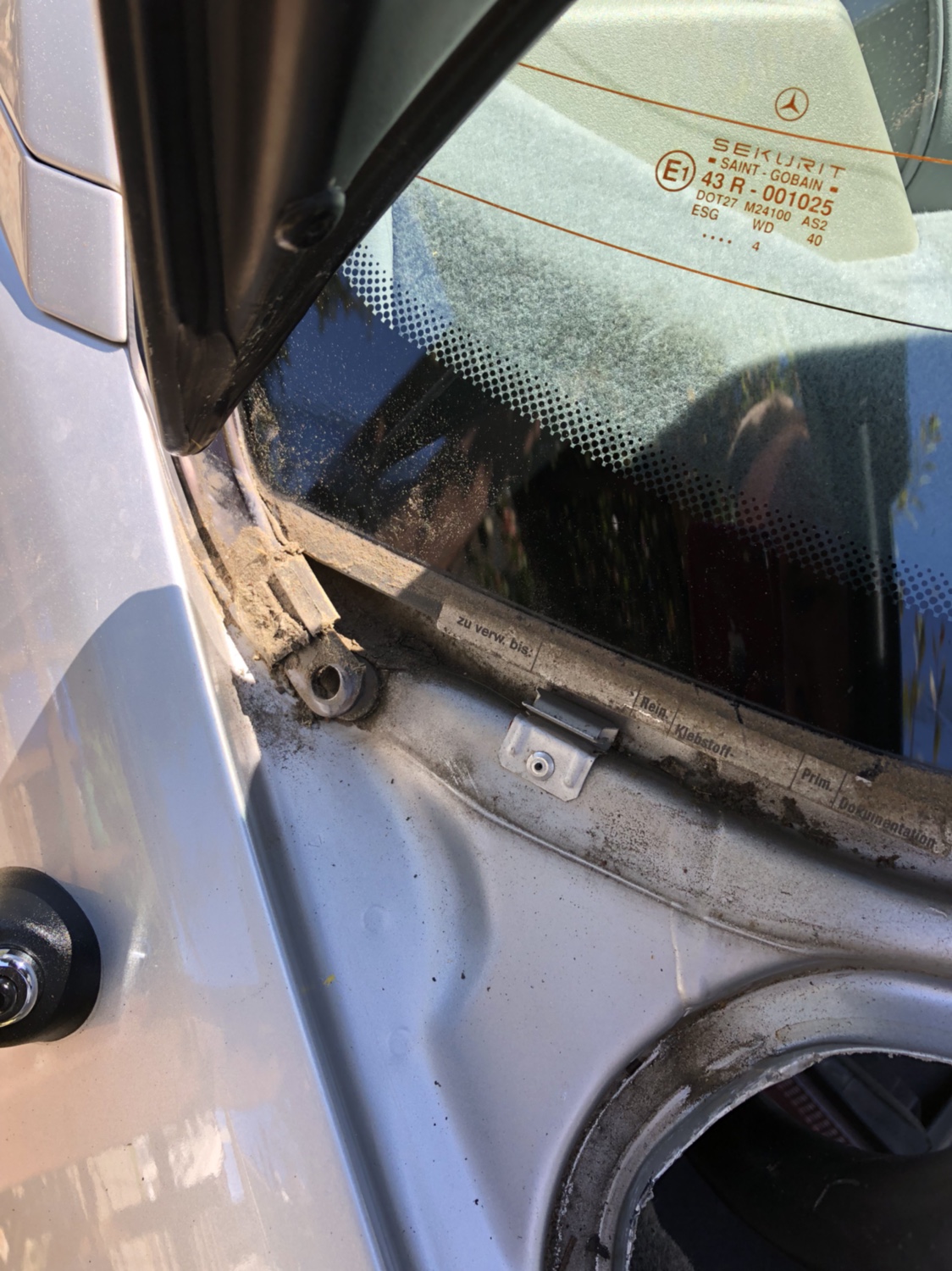

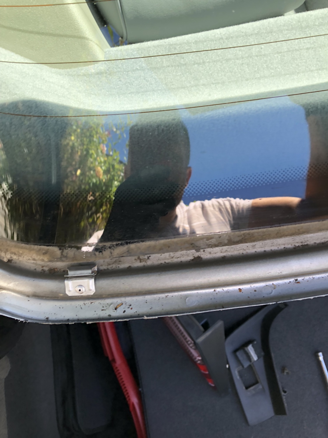

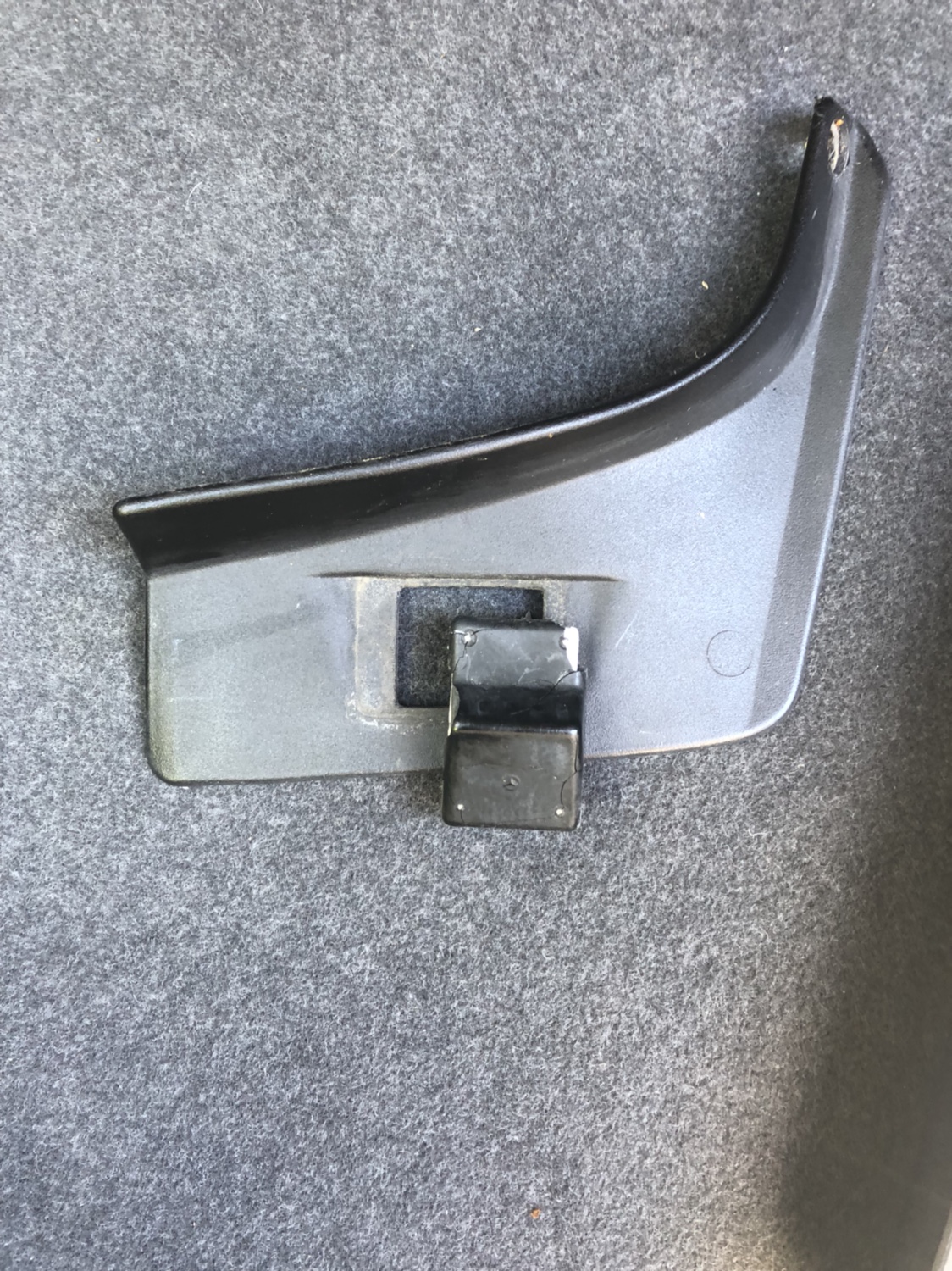

After discovering the leaking cam seal, i spent the rest of the afternoon on the other end of the car. I had bought new trunk bump stops and trim to replace the crumbling original items. I also took the opportunity to take all the rear trim off and clean out the gutters. They were looking pretty gross the last time I washed the car.
Old trim passenger side:
Drivers:
Gunk under everything

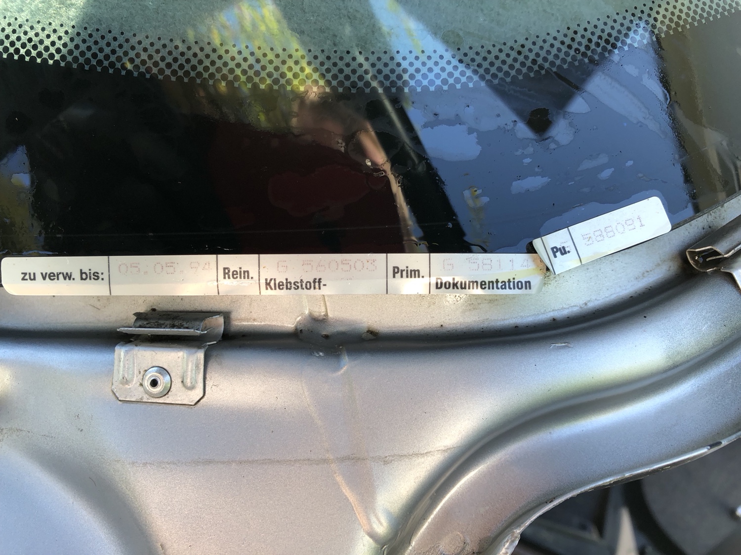

Cleaned it all up and found this manufacturing sticker
May 5, 1994. Which is interesting as the door jamb sticker has an April 94 date.

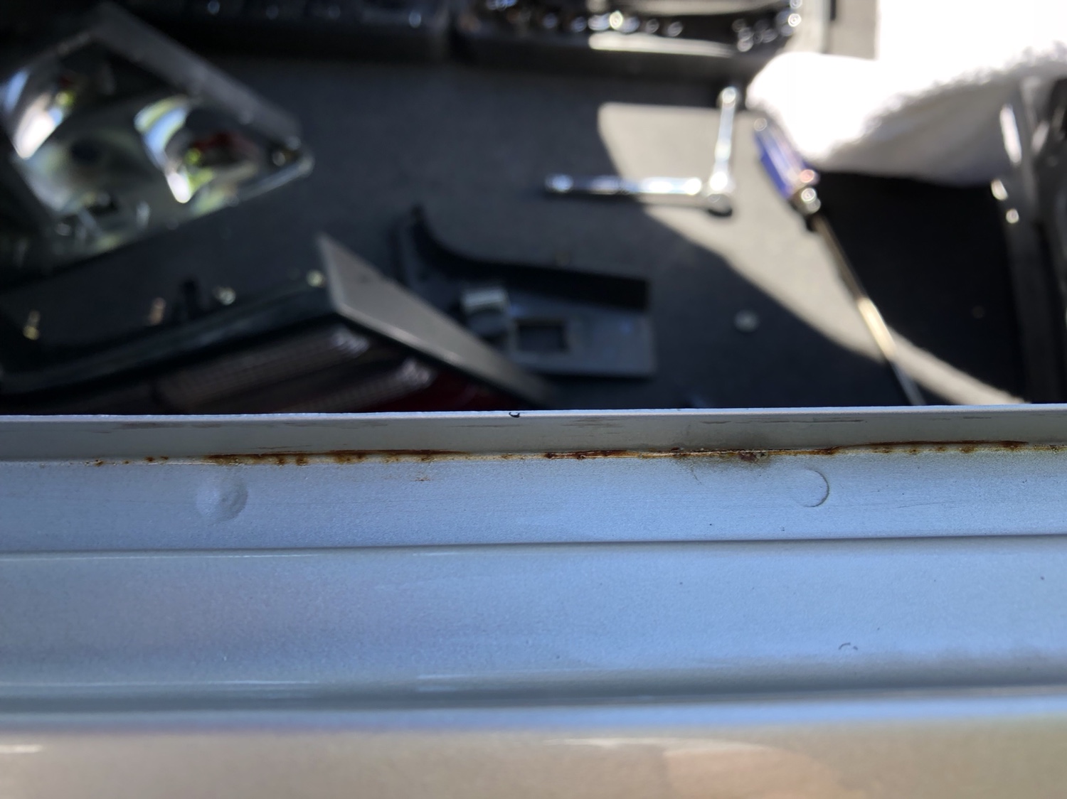

Glad I pulled all the seals off. Found some rust starting. This has been a CA car its whole life.
Coated all the seals with aerospace 303 and popped it back together.
New stops and trims:

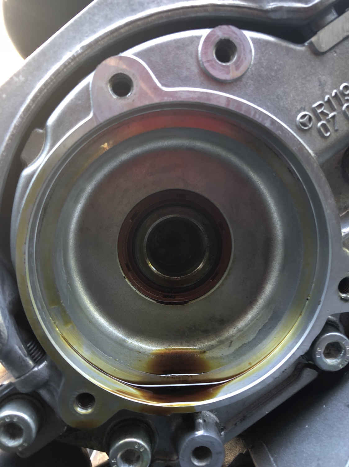

Replaced the leaking cam seal. And I only destroyed two of them before I got it right.
Definitely leaking pretty badly, as I had this area cleaned up after I found the issue this weekend.
Was able to get the seal seated in from the cover face by about 2.25 mm all around.
I used this Volkswagen cam seal i had lying around from my Passat days. Worked out pretty well!
The old seal after extraction
Time will tell if I fixed it correctly, but so far no apparent leaks.

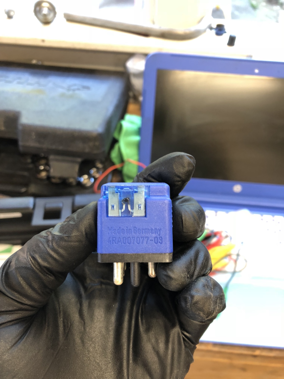

Final piece. I confirmed the aux fans were non-functional on low speed by jumping the ac pressure switch connections. I could hear the relay click... pulled it and found this!
Aux fans are once again functional at low speed!!!
Dave pointed me to a klink post which discussed upping the amperage on that fuse slightly to avoid future blows. I have to do some additional research in that thread before committing to that.
When I changed out the resistor, removed its sarcophagus and rebuilt the wiring harness there, der Klink said to change that fuse as well, and I did. My fans work as intended, the resistor now has heavy duty, heat shrink wiring and the fuse will blow if that resistor or its wiring blow, and not before like it did with the smaller amperage. He also suggested that I cut out a quarter-sized hole in the plastic headlight cap (in addition to the air tube) so more flow on the resistor will keep it from glowing as brightly at temps.

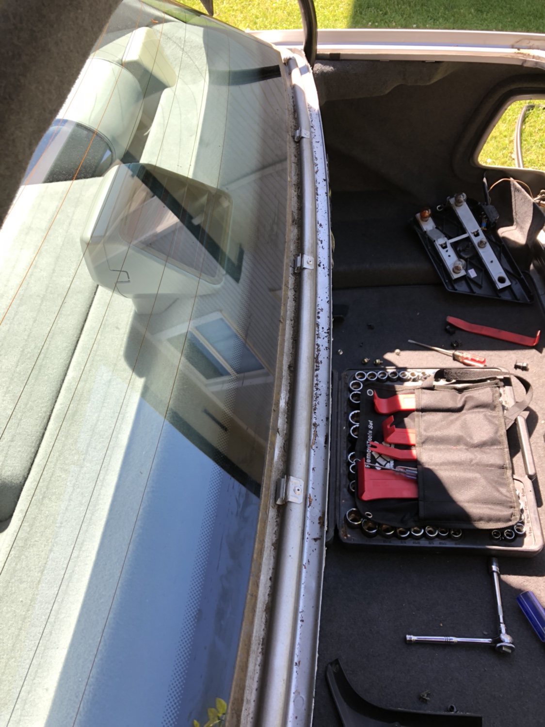

At the next cold start, either pull the rear seat bottom out, or put your ear up to the area on the passenger side. If you hear steady clicking, the module needs the capacitors replaced.
It would be odd if the module wasn't clicking, and caused the RPM fluctuation shown. Although... did you re-set module adaptation, by "clearing" code #1 with a blinker box? I'm assuming you do not have a digital scanner to view adaptation values. Could also be something weird like the existing adaptation being pegged at the limit, and it will take quite a bit of driving for the module to un-learn the old engine, and re-learn the new. Resetting speeds up the process.
