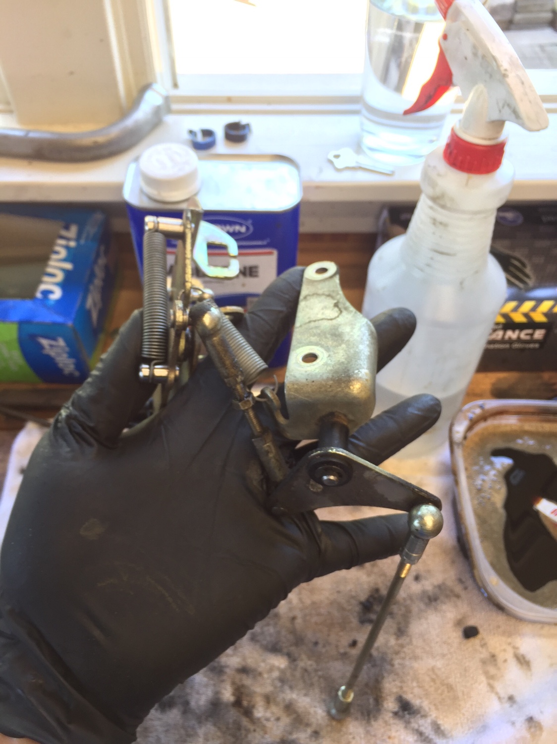

Also took the throttle linkage off to clean it up. Caked on dirt everywhere
Lol, apparently only took photos of the bowden arm linkage.
With all the sliding linkages in that thing, I assume i should apply some grease upon reassembly?

I got most of the residual grease and dirt out of all of the linkage ball joints, and then re-lubed them upon re-assembly with this stuff
I wanted to avoid a thicker paste like grease to minimize dirt pickup, but if anyone has any better suggestions, please let me know. I also lubricated all of the pivot points with that stuff
I mounted the throttle clap trap back up. Is it not supposed to be perpendicular to the intake? Mine looks like its bent forward (towards the front of the car) slightly...

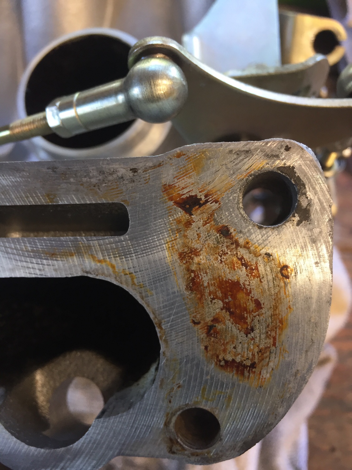

Also found this little manufacturing mark near one of the bolt holes
Not sure if the milling machine initially hit in the wrong spot, or what.

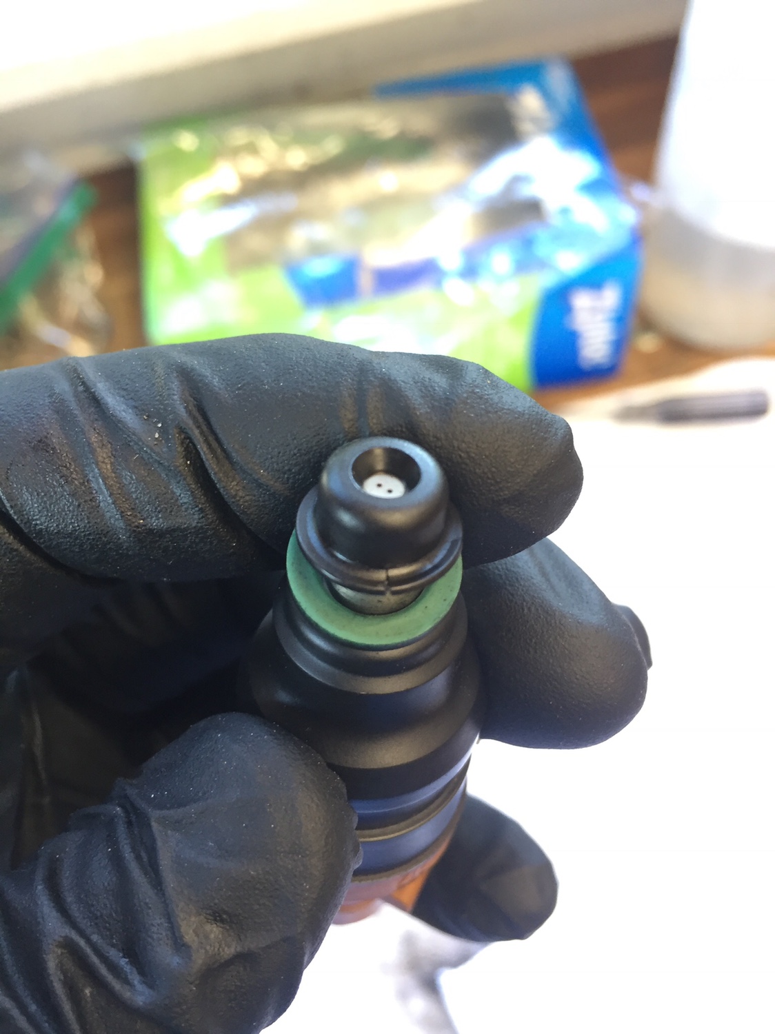

I did note that one of the injectors has a crack in the pintle cap:
Anyone see any concerns with this? I’m planning on using as is.

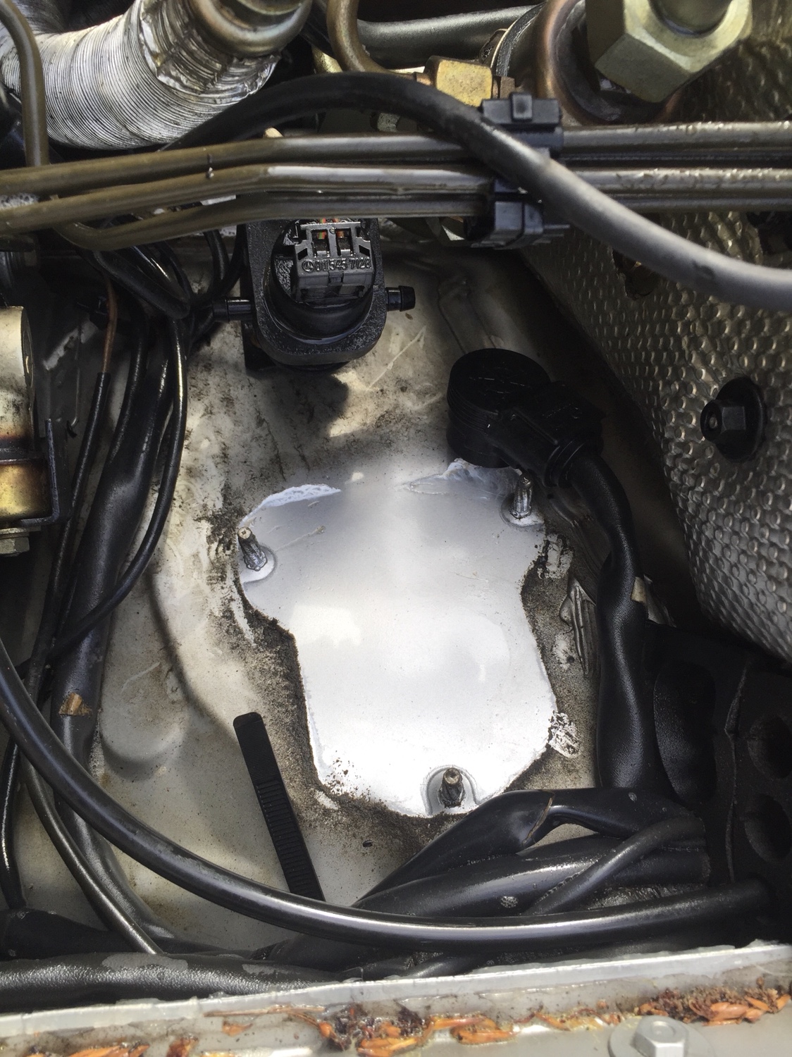

In my last remaining moments, I attacked the drivers side of the head & block.
Before:
After:
Still needs some work, but starting to get there!

For the injector with the cracked top I would buy 1x new (Or good used) to replace it.

Guh... I just looked up the price of one new injector... :barf: :spend:
Yep, I like DarkCISide injectors, which are cheap but do wear out, LH injectors are very very expensive but fortunately don’t wear out with any frequency.
I do keep a set of LH injectors soaking in a jar of kerosene in case I ever do need them.....parts hoard thing.
Because crack pipe :)
No need to buy a new injector. The plastic caps should be available separately (possibly via aftermarket, IIRC?).

This sucker still needs some work, but to give you an idea of the gunk, I thought it was painted black...
That power steering pump had to have been leaking for years.
I’ll probably give the drivers underside a little more love tomorrow, move on to the passenger side, and call the cleaning portion good.

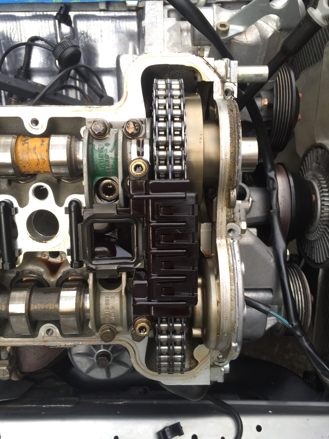

Weeelllll maybe not. Just look at these gross valve covers!!!
:D
Are you replacing the camshaft seals?
Nope. Not planning on it. They aren’t showing any signs of leaking. All oil coming from the top seems to be emanating from the magnets (on both sides non the less), which will be re-sealed with anaerobic.
Very good. My thought was you are there, and look original (shadows make it hard to tell) so it was a matter of time — which could be 12 months or 12 years.
True. I did think about it, but i feel like I have already dug deep enough on this round. Easy enough to pull the caps and rotors off later if they start seeping.
I agree. Over ~15 years and over a dozen different M119's, I've never had these seals leak. If you had the front head covers removed (for chain rail replacement), sure, it's easy enough on the workbench. But if they are dry and you're not going that far in, I'd let sleeping dogs lie...

That being said, I have wondered a little about lowman’s theory that oil and/or moisture is coming through the seals in tiny quantities that we do not recognize as a leak but that may be contributing to the dreaded 119 distributor-itis.
I have 5 M119 engine cars that either I or close friends own. I am going to do them all pretty soon and see how they hold up. At least one of the cars definitely needs [to be] done, because I can see the obviously crookedly installed seal leaking away...
This might make good reading for you. 'RE the magnet oil leak. I'd bet the leak is coming from the magnet themselves....
https://www.500eboard.com/forums/showthread.php?t=10318
The magnets are, by far, the most common oil leak at the upper / front of the engine. The tough part is after you re-seal the magnet, then find out it's leaking between the metal body halves and you need to either cut them apart to re-seal (per the excellent thread linked above), or replace with new. Had that happen [still leaking a bit after re-seal] a few times, years ago, before I figured out what was going on! Grrrrr.
:oldman:
Thanks Joe! Bah! Something else to add to the list! :D
I'll have to look at the magnets closely to see if I see any signs of seepage out of the seam or electrical connector.
Can anyone point me to an FSM description of how the adjustment solenoid works? I haven't seen this type of cam adjustment before...
The M119 FSM doesn't really explain how it works, but the magnet (solenoid) pulls an armature forward which is attached to the advance mechanism attached to the intake cam. The mechanism is pressurized by engine oil, and the oil pressure advances intake cam timing by 25° crank angle. The solenoid just pulls the armature out, which triggers the oil pressure to advance timing.
I think it may be covered in more detail in the M119 engine introduction manual, which is part of the 140-chassis intro manual. Or it might be in the R129 intro as the original system was used on the 119.960 (KE injection), with 20° CA.
Found it! See attached PDF, skip to printed page # 114:

I think I’ve reached my limit of cleaning for this round. Got most of the lower half of the front done, and started working my way back down the underside. Its pretty clean down there now, but not stellar. I figure I’ll be back under there at some point to do the lower harness, and can attack it more then if need be.
Got the drivers side inner fender all cleaned up.

How does this front guide look?
I don’t see anything obvious.
Finished up the night with starting to soak the metal oiler tubes. Cut the old o-rings off and gave em a nice little soak.
Looking good! Regarding the heat sink paste - less is more in that application. The paste is there simply to fill any small air gaps between the inner fender steel and the EZL. Too much paste will actually act as an insulator. I would apply a very fine layer of it.
The upper / center chain rail guides look fine. However! They can look perfect, until you try to remove them... that's when you find out if they are OK or not. The plastic "fingers" should flex easily and allow removal intact. Usually what happens is, the fingers snap off because the plastic is fossilized. The fingered clips are cheap ($10 each or something?) and I would replace them while you're in there. Generally no need to replace the main plastic piece the fingers clip on to. Be careful, if the top fingers snap off, the 2 bottom fingers can break and fall into the engine... extraction can be a chore. It's probably difficult to see, but use a flashlight and eyeball the inner guides below the intake adjusters, make sure the tops & bottoms are still present.
Your engine looks unusually clean inside, btw. The PO's must have either used synthetic, or changed dino religiously. Given the complete lack of the typical brown varnish, I'm suspecting synthetic. Either way, that is a nice surprise!
